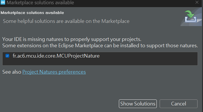

when i import an example from FW package, i got this message.
i have no idea what "nature" is, how could i solve this error?
thanks for your support !

This is example project in the Cube library, created with some other version of Eclipse. It needs conversion. Do not open it directly in CubeIDE. Do: Import... Example project.

and if i don't solve this problem, it won't allow me to build the project.

Hello @HLJ and welcome to the ST Community :smiling_face_with_smiling_eyes:.
I suggest you to:
This methode should work fine.
Best Regards.

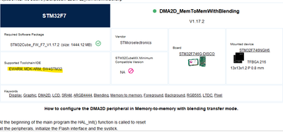

I found the example I'm going to use is not support STM32cubeIDE.
maybe the "nature" problem is because of this issue?
2024-08-26 10:46 AM
Hello @HLJ
To open this project, you have to follow this user manual. For the difference between CubeMX and IDE. First, CubeMX is a graphical interface designed to just do the first configuration and initialisations for your project. For the CubeIDE, it is just a toolchain that we can use to write code, configure parameters, run compile and debug our code.

by the way, I can build and upload the code to the stm32, but the "nature" problem still there.
every time I import an example, the warning pop up. But it seems no effect on my project(?
2024-08-31 2:14 PM
If your project builds successfully, you can delete from the .project file <natures> section the lines that cause warnings (that contain something ....fr)
2024-12-24 7:57 AM
that um2579 is very good hidden. but the question is why is not linked or mentioned anywhere inside that f7 cube package
well done st. seems to me ur not even trying to attenuate tha learning curve
