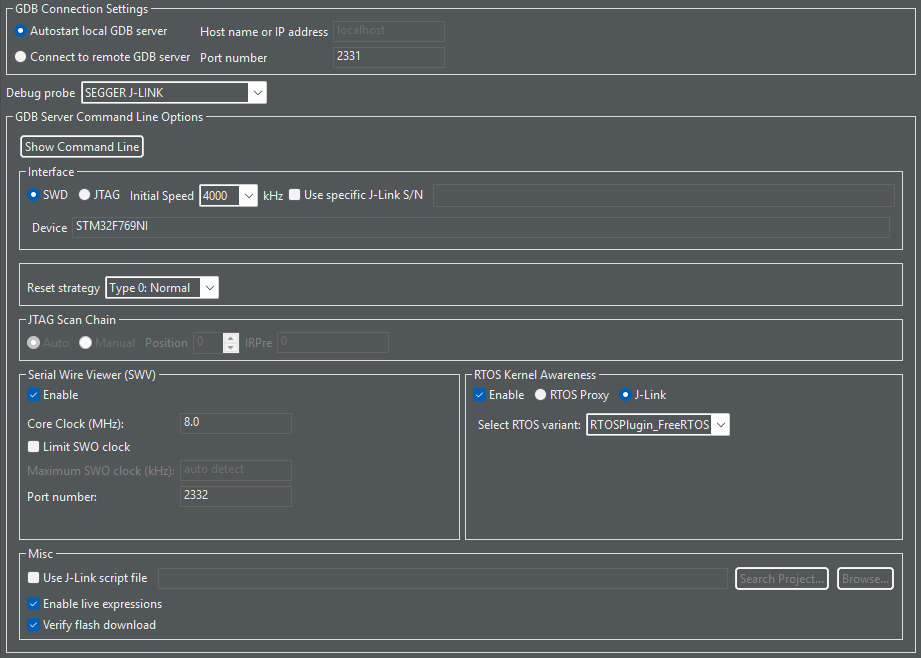

After updating to STM32CubeIDE 2.1.0 I get the following message after starting a debug session. Live expressions do not work.
From the console:
SEGGER J-Link GDB Server V9.14a Command Line Version
JLinkARM.dll V9.14a (DLL compiled Jan 28 2026 17:11:52)
Command line: -port 2331 -s -device STM32F769NI -endian little -speed 4000 -if swd -swoport 2332 -vd -rtos C:\ST\STM32CubeIDE_1.11.2\STM32CubeIDE\plugins\com.st.stm32cube.ide.mcu.externaltools.jlink.win32_2.5.200.202601091506\tools\bin\GDBServer\RTOSPlugin_FreeRTOS.dll

The debug settings:

AScha.3
March 2, 2026
btw You set the core clock to 8M - really run the core at 8 MHz ?? set the real core clock here.
Stefan1
Stefan1Author
March 2, 2026
I have now changed the core speed setting to 216 MHz, but the same issue remains.
Thank you for noticing.

Souhaib MAZHOUDBest answer
March 3, 2026
Hello @Stefan1 @DKilg
Actually, our team are aware of this issue and currently working on resolving it. (Ticket 227696 This is an internal tracking number and is not accessible or usable by customers)
Thank you,
KR, Souhaib

March 23, 2026
This issue has been fixed in the latest version of STM32CubeIDE v2.1.1
