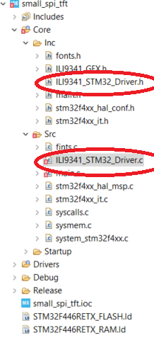

I've created h and c files in Inc and Src folders, I get the following error: "undefined reference to `ILI9341_DrawPixel'
*.h file:
void ILI9341_DrawPixel(uint16_t x,uint16_t y,uint16_t color);
*.c file:
while (x >= y)
ILI9341_DrawPixel(X + x, Y + y, color);
ILI9341_DrawPixel(X + y, Y + x, color);
ILI9341_DrawPixel(X - y, Y + x, color);
ILI9341_DrawPixel(X - x, Y + y, color);

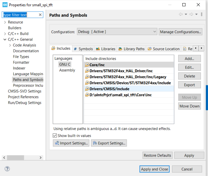

Expect that you will need to #include the .H
If those are in current include paths the compile should find them.

Hi @Community member​ , you're always there for our rescue. Please note the following:
1- Expect that you will need to #include the .H -> included
2- If those are in current include paths the compile should find them. -> in the path
3- Source behind the functions needs to be added via the project tree view.-> yes
0693W00000NskK2QAJ.png4- The error is coming from the Compiler or the Linker? -> error message:
d:\st\stm32cubeide_1.9.0\stm32cubeide\plugins\com.st.stm32cube.ide.mcu.externaltools.gnu-tools-for-stm32.10.3-2021.10.win32_1.0.0.202111181127\tools\arm-none-eabi\bin\ld.exe: ./Core/Src/ILI9341_STM32_Driver.o: in function `ILI9341_DrawHollowCircle':
D:/slntcPrjct/small_spi_tft/Debug/../Core/Src/ILI9341_STM32_Driver.c:23: undefined reference to `ILI9341_DrawPixel'
