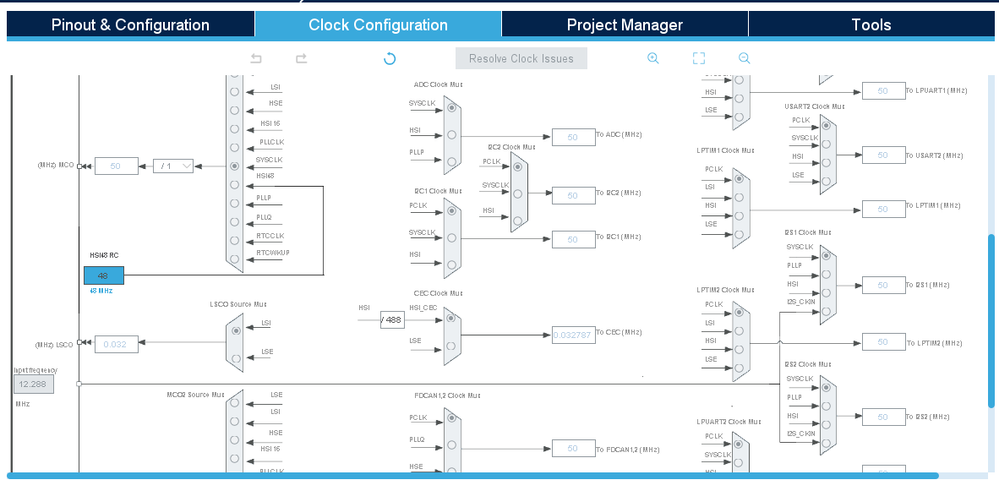

In STM32-G0B1RE, I have an issue of SPI peripheral clock configuration and clock initialization.
  • July 23, 2024
  • 1 reply
  • 1329 views
I'm trying to communicate with external device using SPI, but I'm not getting any SPI peripheral clock at configuration level and there is no clock initialization details in SPI Init();
void HAL_SPI_MspInit(SPI_HandleTypeDef* hspi)
if(hspi->Instance==SPI1)
/* USER CODE BEGIN SPI1_MspInit 0 */
/* USER CODE END SPI1_MspInit 0 */
/* Peripheral clock enable */
__HAL_RCC_SPI1_CLK_ENABLE();
__HAL_RCC_GPIOA_CLK_ENABLE();
/**SPI1 GPIO Configuration
PA1 ------> SPI1_SCK
PA6 ------> SPI1_MISO
PA7 ------> SPI1_MOSI
GPIO_InitStruct.Pin = GPIO_PIN_1|GPIO_PIN_6|GPIO_PIN_7;
GPIO_InitStruct.Alternate = GPIO_AF0_SPI1;
HAL_GPIO_Init(GPIOA, &GPIO_InitStruct);
/* USER CODE BEGIN SPI1_MspInit 1 */
/* USER CODE END SPI1_MspInit 1 */
1 reply
July 23, 2024
I'm not sure what you're showing us here, perhaps a misunderstanding?
HAL_SPI_MspInit initializes the pins, that's it. The peripheral initialization will be in MX_SPI1_Init which calls HAL_SPI_Init. The function MX_SPI1_Init should be in main.c.
