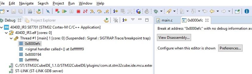

...Target halted (Vector catch, PC = 0x08000EFC)

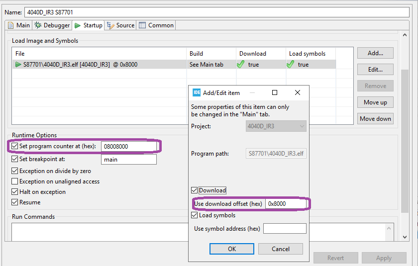

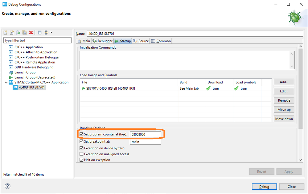

0690X00000BvmfZQAR.jpgUsing STLink:

MFend

From the post at https://www.openstm32.org/forumthread2364 I understood another step, but it still didn't help the debugger to know where to start...

I upgraded to STM32CubeIDE 1.2.0 - still no change...debugger insists on starting at 0x8000efc!
