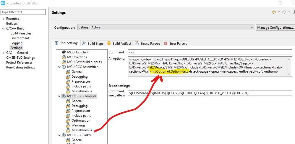

I want to add a compile option
‎2021-04-06 11:51 PM
environment:
STM32CubeIDE Ver1.6.0
Thank you for helping.
How do I add image compilation options?
Thank you.

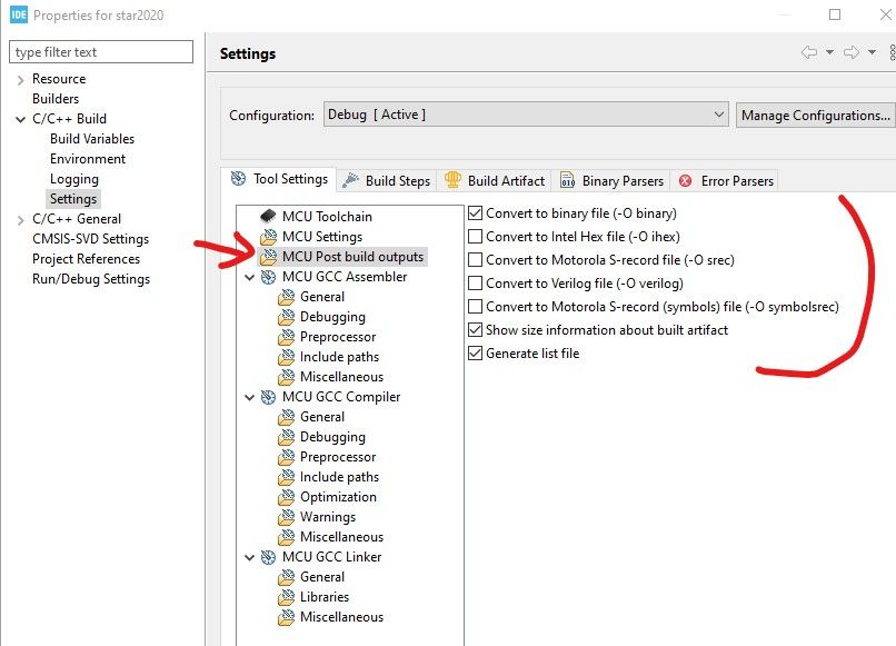

‎2021-04-07 12:09 AM
Custom settings can be set like this:
If discussing about binary artifacts some presets are available:
‎2021-04-07 5:28 PM
Hi Cartu38
Thank you for your response.
I'm sorry to have you prepare the image.
I understood it well.
I'll give it a try.
‎2021-04-07 5:30 PM
Hi Cartu38
Where are the pre-existing compile options set?
Can't it be edited?
