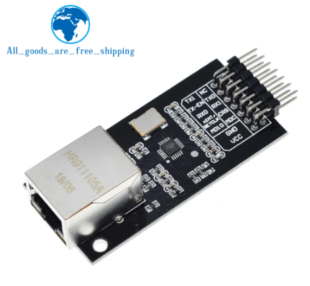

right. need interface chip. i would take a cheap module, like this:
https://de.aliexpress.com/item/1005004446133417.html
0693W00000aH4K3QAK.pngalready with rj45 ...

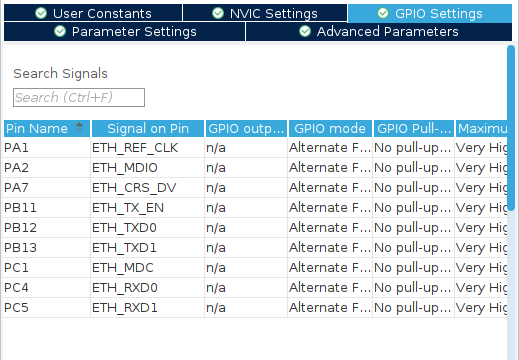

to connect : gnd, vdd , and these 9 pins:
