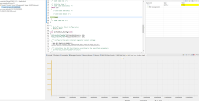

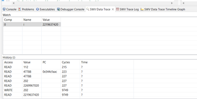

I would like to trace the variable through SWV data trace, trace log and also I want to get the data to plot via SWV Data Trace Timeline Graph. Eventhough when I make the required setup as below, I cant get the expected trace data, could you pls help me resolve ?

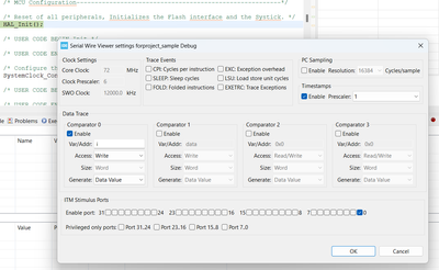

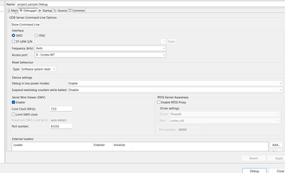

  1. Enable serial wire viewer through debugger
  2. Add the data into data trace
3. When I resume debugging I get the following values in SWV Data Trace, SWV Trace Log and SWV Data Trace Timeline Graph respectively
I would expect to see i incrementing from 1 to max value of uint16_t that is 65535.

Thanks Rim. I am using STM32 CUBE IDE 1.14.1, my board is STMF407VG-DISC1.
I cant see the same result as yours.

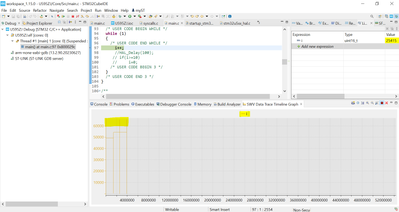

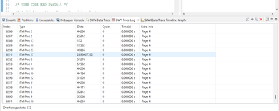

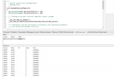

First of all, I am expecting to see in watch window that is under SWV Data Trace, the value of i to increment starting from 1 to 65535. This is not the case for me. Below is the case for me.
Second of all, I have no idea at all what the cycles and time is for under history(i) window. When I try to scroll cursor up, the cursor automatically pulled downwards, so I cant see the first value in the history.
I also dont understand why values in history is not incremented by 1, there is difference between values by 47 or 48. I cant understand the logic behind.

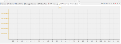

Finally, the SWV Data Trace Timeline graph. Below is what I see. I dont understand what this means actually..
Could you please comment ?

STM32F407VG-DISC1
Would make sure the SWO/PB3 is physically connected. Check if there is a Solder Bridge and it is made.
Frequency of the core in actuality, and that believed by the debugger must match.
SB12
https://www.st.com/resource/en/schematic_pack/mb997-f407vgt6-e01_schematic.pdf
