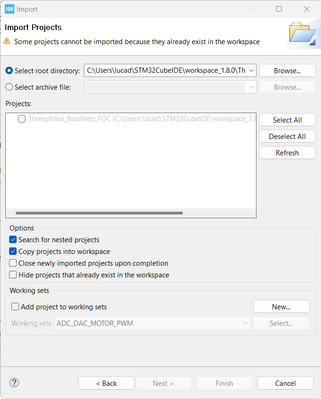

I put this folder in the workspace with all the other projects:
Now I have to import it as I have always done: file - import - existing projects in the workspace
I cannot press on "finish"

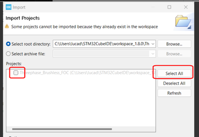

You have to select something to import!
Either check the box next to your project name, or just use the 'Select All' button:

The problem is that it won't let me select it..
But I think I figured out why, there is a warning that the project already exists in the workspace .. probably because the folder name to import is different from the actual name of the .ioc project inside.
I lost an hour because I thought I was importing the wrong way.
I will update you
July 30, 2024
If the project is grayed out, it already exists in the workspace.
