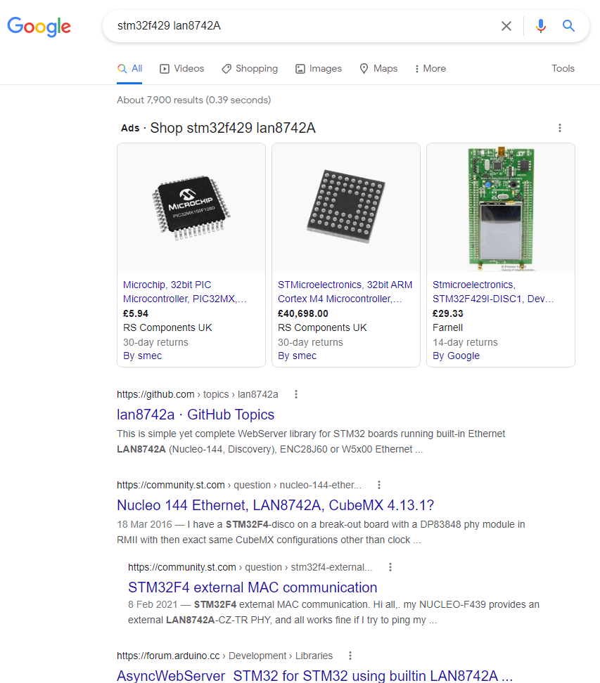

So what, exactly, have you tried? Where are you stuck?
Did you try a Google search?
When searching for code, GitHub is a good place to search ...

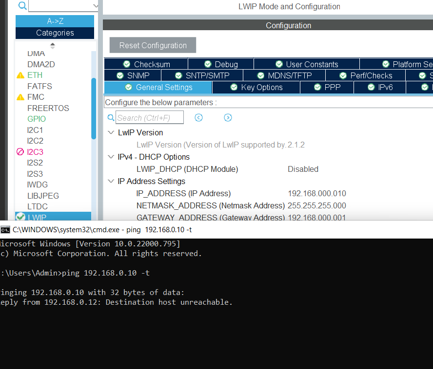

I have a stm32f429 nucleo board.and in that board already attached lan8742a chip and ethernet port also.I cant hardware configure.I searched google and github also no clue i have found. whenever I write in cmd prompt "ipconfig" that time default ip shows every time. I want to show my static ip like 192.168.001.111.

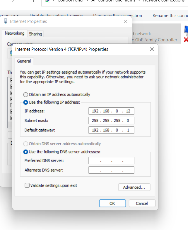

What are the IP settings on your PC (IP add, netmask and gateway). Is there a router/gateway between your PC and the NUCLEO board? Or just an Ethernet switch?

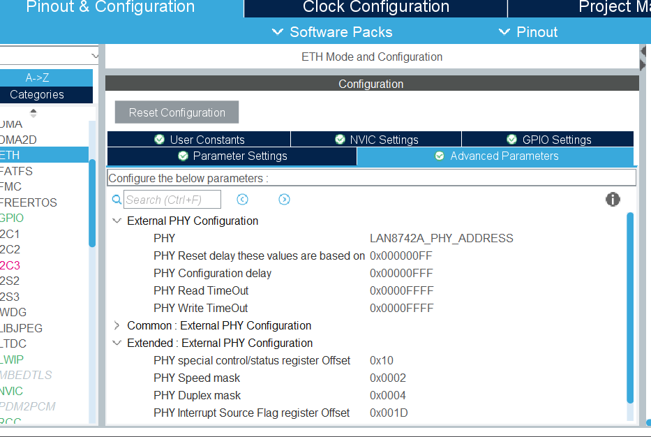

Check the CubeMX Ethernet "Advanced Parameters" tab. In my experience (using CubeMX 6.3, can't recall if I've tested with later versions), CubeMX defaults to some incorrect register addresses and bit field values. You will need to double-check those values with the LAN8742 data sheet. Specially the "Extended External PHY Config" registers, but double-check all those settings.

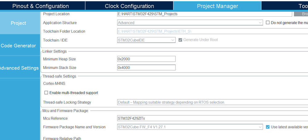

Which version of CubeMX and the CubeF4 library are you using to generate this code?

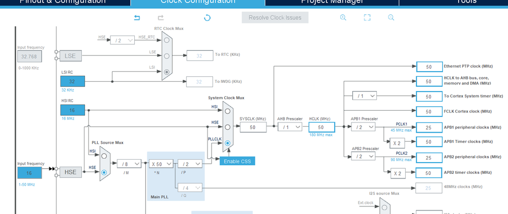

0693W00000QM8O6QAL.pngthis is advance parameter options that i have set.0693W00000QM8OOQA1.png

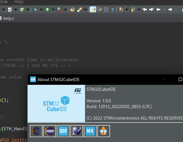

STM32Cube FW_F4 v1.25.1
version 1.9.0
