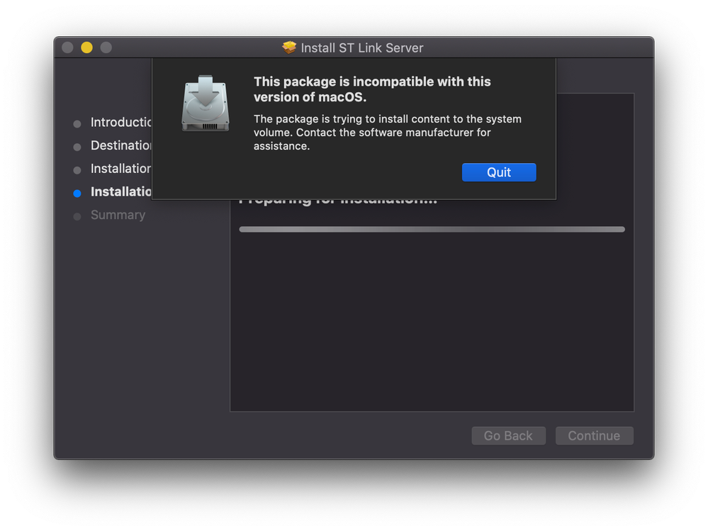

I am trying to instal stm32 cube ide in my new Mac book air . there is error : This package is incompatible with this version of macOS. , . please help me for install cube ide in my new MacBook Air
  • October 20, 2019
  • 5 replies
  • 2640 views

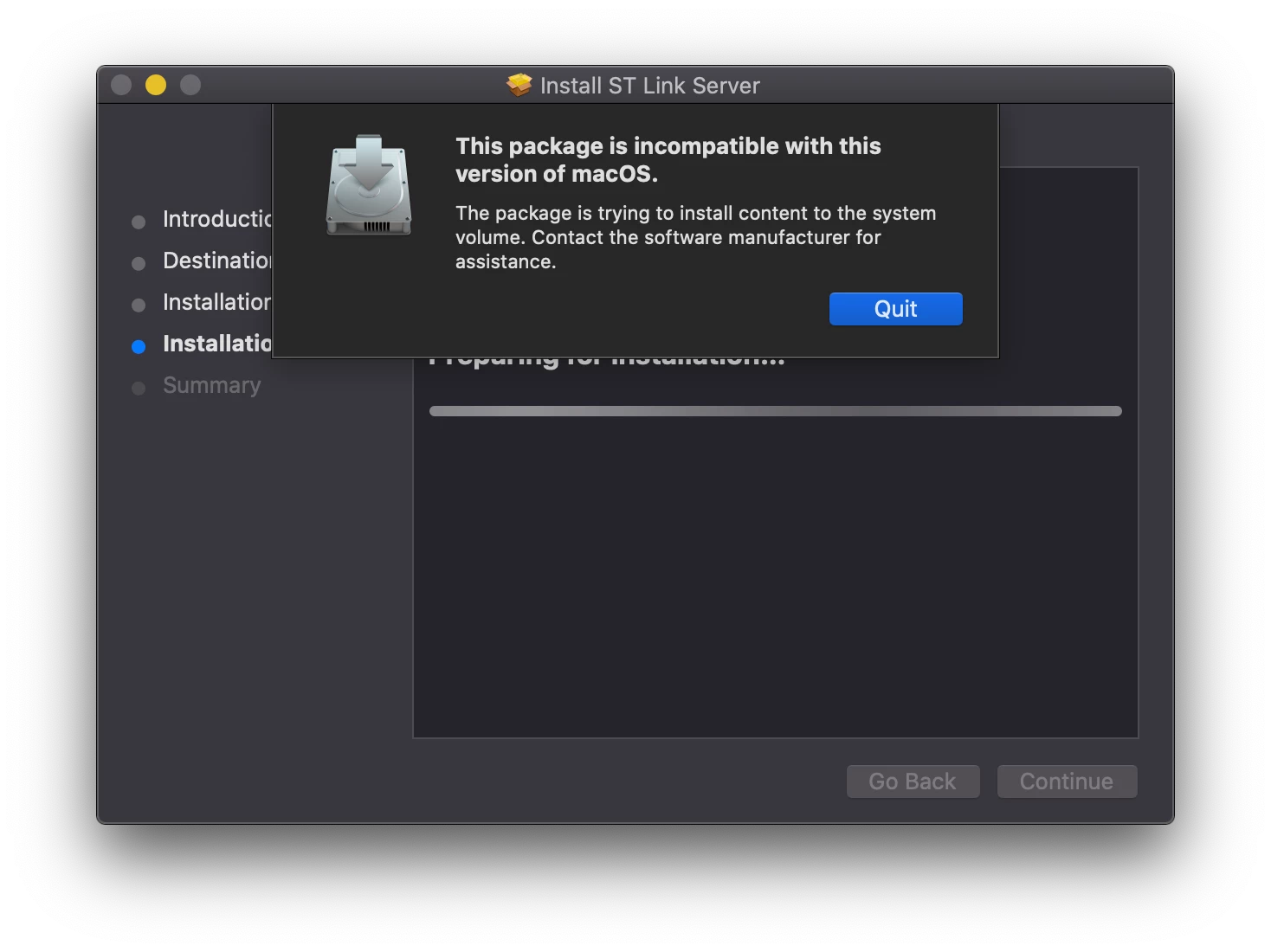

I am trying to instal stm32 cube ide in my new Mac book air . there is error : This package is incompatible with this version of macOS. ,The package is trying to install content to the system volume. Contact the software manufacturer for assistance.
my Mac OS is Catalina
10.15

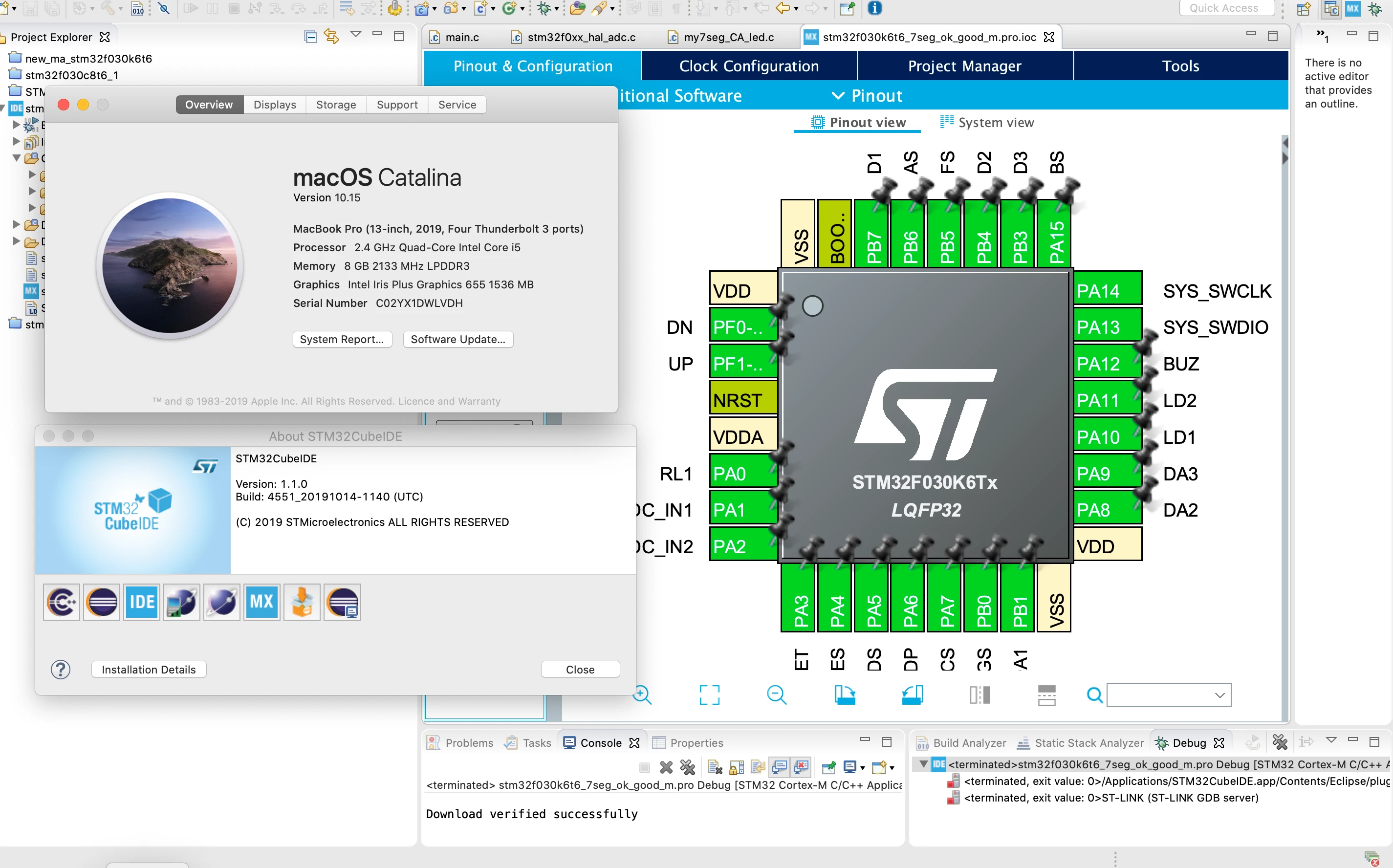

Same issue here with Catalina 10.15.1 Beta (19B77a). I have yet not managed to have it working but I slightly improved the situation:

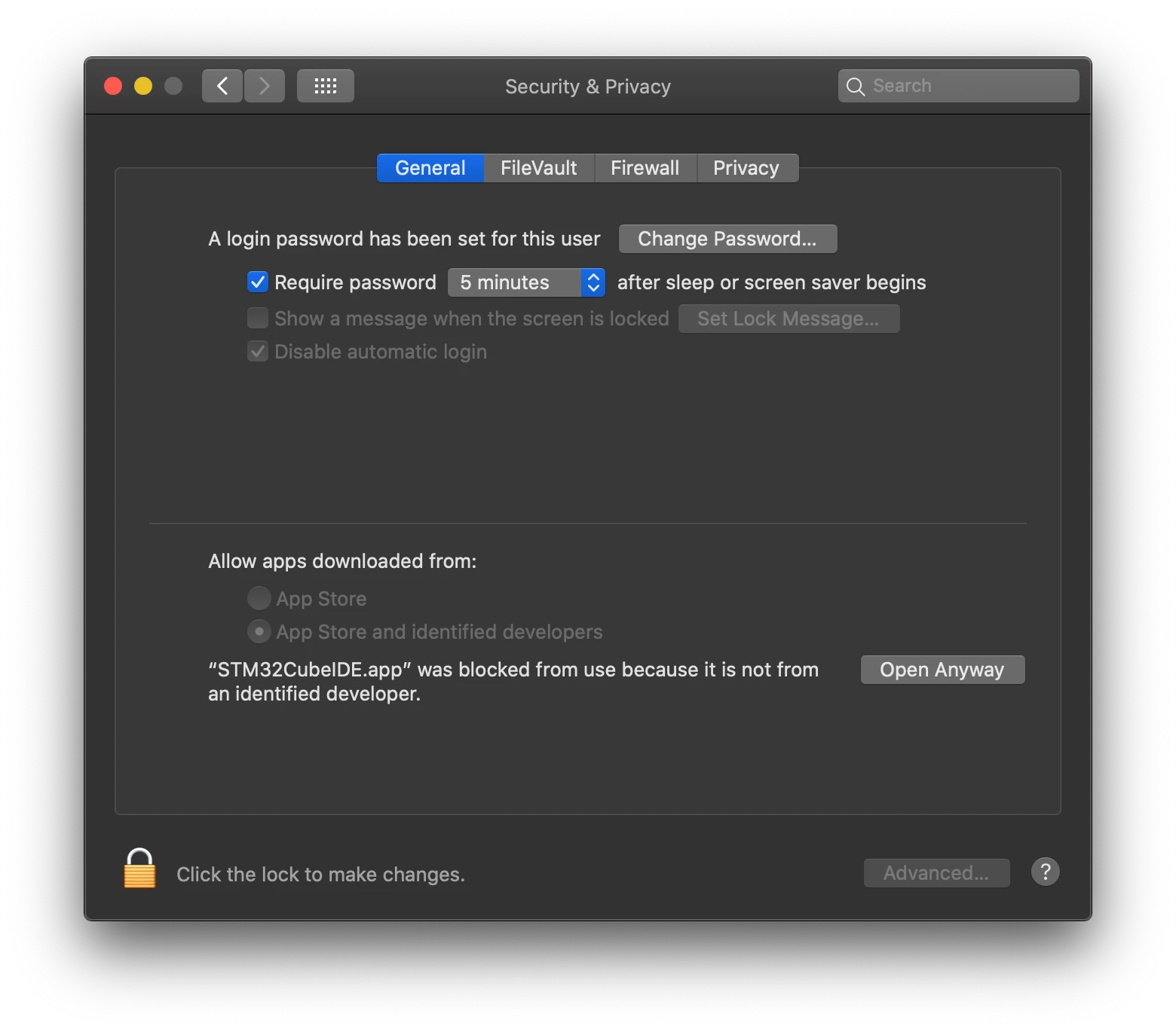

I went to System Preferences > Security & Privacy > General and allowed STM32CubeIDE.app:
IDE was able to launch but it takes a very long time with "Checking for Updated Files ..." modal. I cannot Cancel or Close this modal window.
As well, there is an issue with "st-stlink-server.1.2.0-3.pkg": This package is incompatible with this version of macOS.

11:52:08+03 Installer[3042]: Package Authoring Error: Package contains system volume install location content. Installation cannot proceed since installing to the system volume is not possible.
11:52:08+03 Installer[3042]: Package Authoring Error: Package contains system volume install location content, and installation will fail: Error Domain=IFInstallErrorDomain Code=-6000 "This package is incompatible with this version of macOS." UserInfo={NSLocalizedRecoveryOptions=(
  Quit
), IFReadOnlyPathsKey={(
  "/delivery"
)}, NSLocalizedRecoverySuggestion=The package is trying to install content to the system volume. Contact the software manufacturer for assistance., NSLocalizedDescription=This package is incompatible with this version of macOS.}
11:52:14+03 Installer[3042]: Client requested cancelation of install following warning.
11:52:14+03 Installer[3042]: Halting PK session due to client response to warning This package is incompatible with this version of macOS.
11:52:14+03 Installer[3042]: Install failed: The Installer could not install the software because there was no software found to install.

I have solve other way . 1 first from Catalina downgrade to Mojave and then install old version cube ide and update all cube ide then upgrade to Catalina . and working very nice happily .:grinning_face: .
