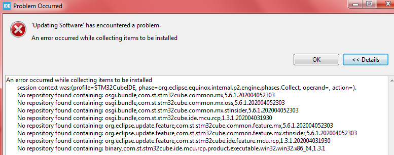

I am using STM32CubeIDE ver 1.3.0. I tried to update to version 1.31. But unsuccessfully. Where the problem?

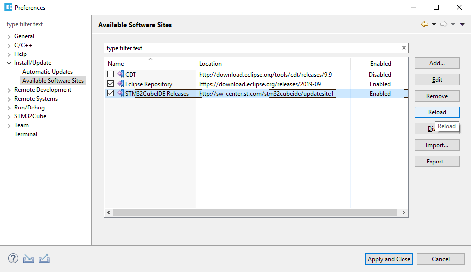

Do you reproduce after restarting STM32CubeIDE and/or Reloading the update server URL from preferences?

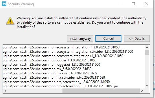

The update modules still are unsigned :baby:
Indeed, hopefully it will be fixed with one of next releases...
Yes, I tried it. It still does not work anyway.
Peter
Well your screenshot below wrongly made me think that your update was fine...

Could you share here your full list of available sites?
Or at least, try to update (Help > Check for Update) by having only checked the STM32CubeIDE site url: http://sw-center.st.com/stm32cubeide/updatesite1
