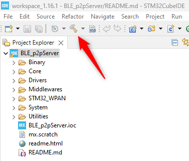

i am not able to create an example project because i always get the message "Your IDE is missing natures to properly support your projects" after i want to finish the project setup.
What does this mean?
If i cancle it, i am not able to build the project, because the "Hammer Symbol" is not active:
in CubeIDE 1.14.1 for example it works.

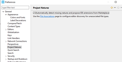

Hello @ledi7 ,
Try disabling the "Automatically detect missing natures and propose IDE extensions from Marketplace" in Window > Preferences: General > Project Natures.
