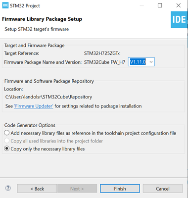

I’m using STM32CubeIDE headless-build script in Linux for developing the software.
I have a question regarding how to check the version of the firmware that I’m actually using in my environment.
I tried to set a certain version of the firmware by writing the following syntax in package.xml as below.
<?xml version=“1.0” encoding=“ISO-8859-1" standalone=“no”?>
<Package DBVersion=“2.0">
<PackDescription Release=“FW.H7.1.11.0”>
<Note Release=“ReleaseNotes.html”/>
</PackDescription>
</Package>
After executing headless-build, I tried to find the evidences that I have actually used FW.H7.1.11.0, but unfortunately I couldn’t find anything in my filesystem.
I just would like to get the confirm that I’m using FW.H7.1.11.0, but I have no idea for now. If you have any idea to do that, that would be very nice to me. Thanks in advance.

When (re)generating code with STM32CubeMX (or the build-in generator in STM32CubeIDE) it will copy the library files if you have selected one of the copy options (I would not use the reference option, unless you put the firmware pack in a submodule since you have no guarantee about the integrity of files outside of git). If you have "Use latest available version" checkbox unchecked in Project Manager it won't change the version! If you don't have the firmware package of the selected version on your system you'll be prompted for download it when generating. This is why I like to archive specific versions of STM32CubeMX and firmware packs so you can still make changes to your configuration without the need to download more files or the need to copy them all in your repo.
It won't copy anything during build.
So if you have a clean recursive checkout and use the same STM32CubeIDE version for your headless build you should get a bit-identical binary (even same if you build under Windows or Linux, though formatting of hex/elf files might slightly differ).

Hello @u1kano and welcome to the community,
If I understand correctly, the problem is that you are not sure that you are using the right FW package.
If this is the case, you just need to confirm when creating the project that you have used the correct firmware package name and version as shown in the screenshot.
Thanks,
Rim

- Will the "Firmware Package Name and Version" set during project creation remain fixed unless modified?
- Is the Firmware Package copied every time during the build process? Or is it reused if it's the same version?
