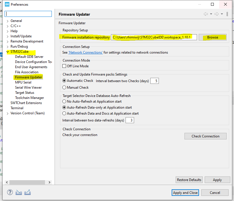

By default, in Windows, STM32CubeIDE downloads all firmware dev packages for all MCUs used into a Repository folder under the User folder for the user installing it, e.g.: C:\Users\User Name\STM32Cube\Repository.
I don't want it there, actually not even on that drive at all.
How do I change that Repository path?
Best answer by Wijeden RHIMI
Hi @Community member​ ,
Under Window --> preferences , then try to do the same thing as shown in the screenshot bellow:
Don't hesitate to ask more questions.

I haven't tried this, and I don't run CubeMX from inside IDE, but....
In standalone CubeMX go to Help->Updater Settings. There is a field for repository folder. Try that.

SKled.1
SKled.1Author
Senior
March 29, 2023
Ah, thanks. It's under Window here, not Project.
Wijeden RHIMI
March 29, 2023
Hi @SKled.1
Yes yes under window sorry :)
Does this solution solve your issue ?
Wijeden,
SKled.1
SKled.1Author
Senior
March 29, 2023
Yep ;)
