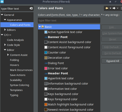

    try here :

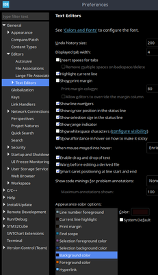

    should be here : + de-select : system default !
    but maybe color from system because :
    - so change color in system settings (try... :) )

    Thanks. I have checked the system colour, the background is full back (RGB 0,0,0) so it is not being picked up from there. The "System Default" checkbox is unchecked.

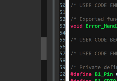

    I did discover something interesting though. Have a look at this:
    I have the window split vertically, and the cursor is on the right side. The background colour is not the same in each window. The one on the left is my setting. As soon as I move the cursor to the left side, the colour changes to match the right side.
    So it looks like the background colour setting you mentioned is used, but then overridden. My guess would be something in the syntax highlighting code is doing it, and moving the cursor to that window causes it to refresh.
    I can't find any option in the syntax highlighting bit that corresponds to this grey colour though, so I can't find where it is coming from.

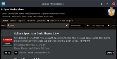

    Could you, please, try to install the Darkest dark theme from eclipse marketplace following these steps:
    1. Open STM32CubeIDE
    2. Open "Eclipse Marketplace" from "Help"
    3. Search "Darkest dark theme " in the search box
    4. Install "Darkest dark theme with DevStyle"
    5. In "Confirm Selected features", make the configuration as default and click on "Confirm"
    6. Accept the item of the Liscence Agreement and click on "Finish"
    7. Wait for the end  of the installation and restart the STM32 CubeIDE
    8. Click on "window" => "Preferences" => "Version Control" and check that "Darkest dark theme" is added.

    Thanks, but this doesn't work. When I install the theme and restart it does not appear in the list of installed extensions, and it is not selectable as a theme.
