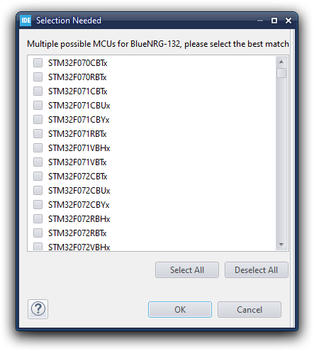

How do I import TrueStudio project for BlueNRG-2?
  • November 6, 2019
  • 1 reply
  • 1492 views
The BlueNRG-1/2 SDK provides sample projects in TrueStudio form. When I attempt to import any of them into STM32 CubeIDE, I am presented with a dialog asking for the proper MCU for the evaluation board. If there is a way to determine the correct answer to this question, I'm too dense to figure it out and ST doesn't seem inclined to tell you in any of the copious but, for these purposes useless, documentation.
Thanks for the help.
1 reply
Herve PIERROT
November 8, 2019
BlueNRG is supported by different solutions, such as TrueSTUDIO, but STM32CubeIDE is focusing on the STM32 ecosystem and BlueNRG is not an STM32 device.
That's why STM32CubeIDE doesn't support this device and that you don't find it in the STM32 device list.
