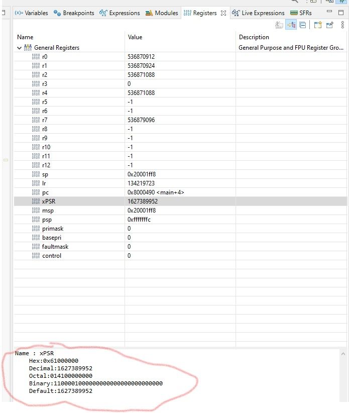

Hi, is there any way to display the xpsr register with the flags decoded in debug view. I can see the xpsr register in the Registers tab, but it just shows the hex/binary value of the register

Are you looking for more than that ?

‎2021-02-20 1:04 AM
I was hoping to see something like the xPSR expansion in keil:

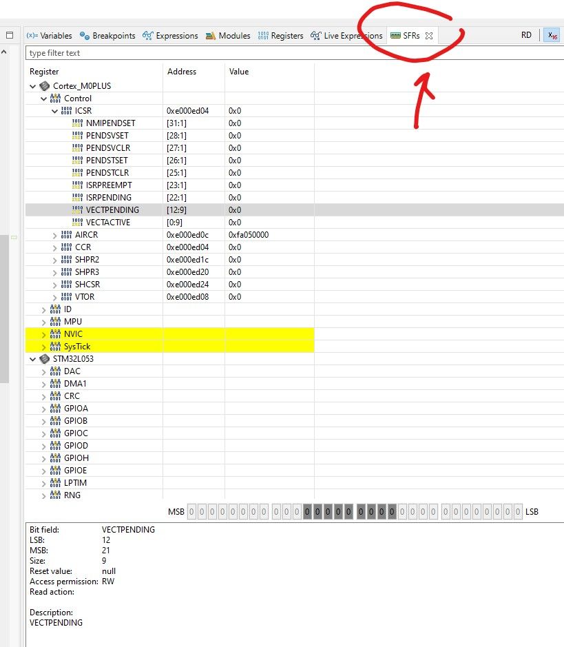

Look at SFR view
Options
‎2021-02-20 1:50 AM
I've looked through the SFRs view, but I dont see xpsr there
