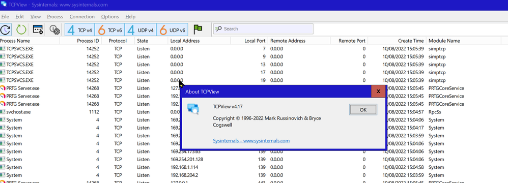

Just use Sysinternals TCPView (or similar tool), find the port in the list and 'Close Connection'.
Try programming again.
2022-08-13 8:51 PM
Like RRei.1 said you can use tcp view.
You can get it here, it's the new improved version better interface and yopu can filter for ports.
Regards
Rob
