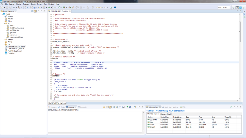

Hi everyone ! Can you tell me please how to show memory regions of sdram in STM32CubeIDE thank you

Add it too the linker script (.LD) as a named section
Would be 0xC0000000 or 0xD0000000 depending on the bank
June 7, 2020
> why used 0B
Are you storing any variables in there that the linker knows about? If not, it'll show as 0 bytes used.
