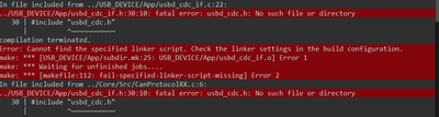

I'm trying to porting my project on STM32CubeIDE and getting this error so I was thinking it's because I'm migrating my project. Can anyone guide me how to resolve that?
Best,
Luci
It's better to post messages as text, using the 'code' button:
It's telling you that it can't find the file usbd_cdc.h
So the first thing to check is: does that file actually exist at all ?
If it does exist, is it in a place where the compiler is looking - ie, somewhere in your Include Paths ?

I just checked my whole directory and I'm unable to find
usbd_cdc.h
 in that one so, can you please suggest where to find this file. I mean it's auto generated or what I confused.
So where was it originally in the project you're porting from ?

The link script (.ld) not found: check the name and location.
Some include files not found: check include paths.
