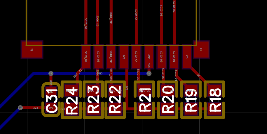

  • The code runs on a custom board where pull-up resistors of 10K are placed on the SD card pins :0693W00000AOMt6QAH.png

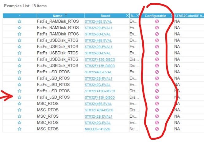

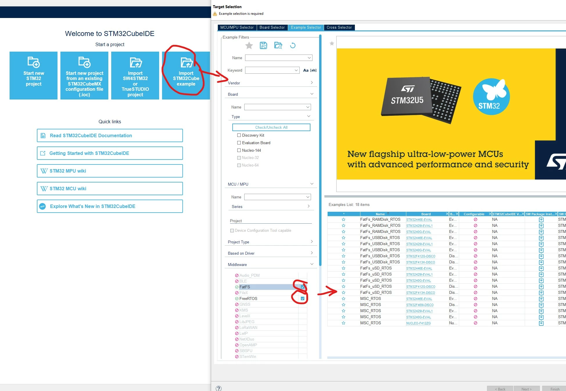

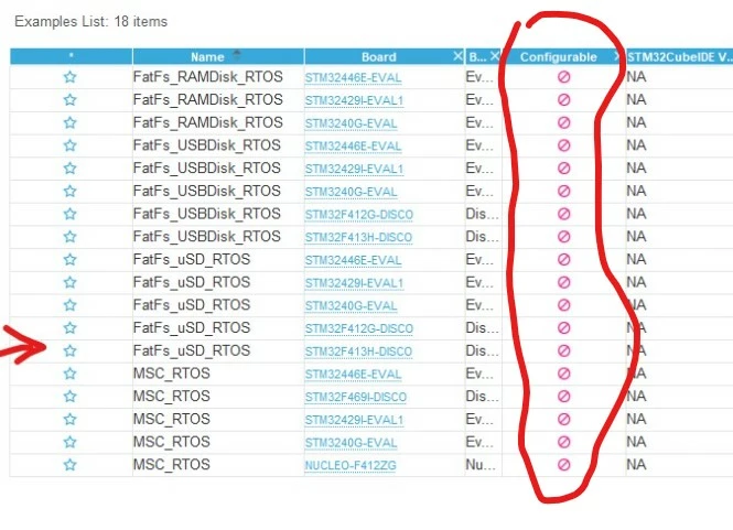

April 26, 2021
Even easier ... let's rely on example browsing import and feature ...
Either from welcome page or from File > Import > General > Import STM32Cube Example
DFres.1
DFres.1Author
April 27, 2021
Thank you for your prompt reply, I should have specified better the question.
What I am interested in, is the full project files including also the .ioc extension from CubeMX.
Meaning, the example starting from CubeMX to CubeIDE.
I would like to see the MX configuration for clock settings and peripherals and then the code.
Cartu38 OpenDev
Graduate II
April 27, 2021
Unfortunately sounds no example supporting configuration

Here is an example for all of you that are still stuck with the same problem.
In the example, you can find the project file for STM32CubeIDE and STM32CubeMX.
I'aware of the fact that the code is clumsy but it will give you an idea on how to set some of the parameters for the MCU.
The example works with SDIO 1 bit mode.
Few things to be aware of:
