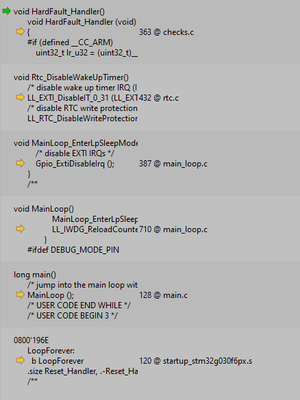

I've a project which are build with the STM32CubeIDEA Version 1.16.0. I use the tool chain 11.3.rel1. After build with optimisation -O0 the application works without problems. It is implemented with bare metal and with using of the LL version 1.6.1 for the G0 library.
Now when I build the application with a other optimisation, like -Og, the software runs in a hardfault exception.
After some days, today, I will search for this problem and collect all information. And murphy struck. I can't reproduce this problem.
I remeber me on the following information in the hardfault exeption:
  • it was equal which optimisation I used, the behaviour was the same
  • the LR register value was 0xfffffff8 in the hardfault exeption handle
  • the callstack history show me the same calls
  • the last function the the callstack history was a ISR, which IRQ was disabled
So I have here found a other problem https://community.st.com/t5/stm32cubeide-mcus/stm32g0-hardfault-and-signal-handler-fffffff1/m-p/676866 . If this the same problem? My MCU have only one Flash bank but the main loop runs into the RAM for using the performance without wait states from the Flash.
Exists a Errata Sheet to the Bug in the Silicon?

OK, the R15 (PC) is not correct. Why? At the moment no idea.

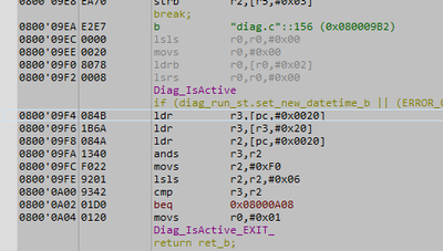

Now, I have show what is at this address for a function with the dissassamble:
But the callstack from the MCU show me a other address:
I dosn't understand it at the moment, why is a 32bit ASM command is broken inside.
I use for the main loop only RAM functions, to becomes the needed performance. But the function Diag_IsActive() is placed into the flash. If this a problem?
