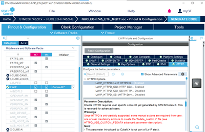

"I am trying to configure an HTTP server on the Nucleo-H745ZIT6 board, which has two Cortex cores. I am using Cortex-M7 for this. After enabling HTTP in middleware inside LwIP, and generating the code, LwIP is placed inside the Cortex-M7 folder, but the HTTP code is generated outside of it. When compiling, I get an error saying 'fsdata.c: No such directory.' They are adding the HTTP image inside the HTTP folder, but I need to configure the resources configuration but not getting the option and I'm not sure how. Can you help me with this?"
i am using stmcubeide 1.15.1 software

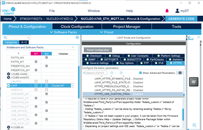

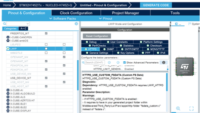

Hello @ggowd.1
First I recommend you to use the latest version of CubeMX 6.12.1 and CubeIDE 1.16.1
After checking your IOC , all you need to do is to add the fsdata.c manually to your project ,
If "fsdata.c" has not been copied in your project, it can be taken from the Firmware Repository (Menu Help > Updater Settings...) Software Package folder within Middlewares\Third_Party\LwIP\src\apps\http folder.
actually those informations are mentioned in parameter description
THX
Ghofrane
