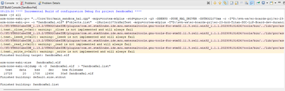

I also notice some errors which appear only during the first compilation:
(_write is no more in compilation error thanks to the previous definition)
So now I enter the __io_putchar function when I call printf.
But I can't get something appear in the terminal.
Whereas it works whith other other projects, so the terminal and uart used are OK.

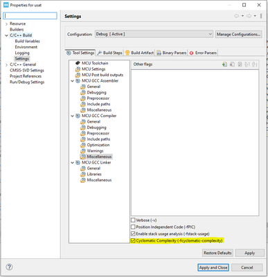

Hi KDJEM.1, thank you.
I tried to downgrade and use the gnu toolchain 10 2021.10 in my current projects.
But I now have this message :
arm-none-eabi-g++: error: unrecognized command-line option '-fcyclomatic-complexity'
KDJEM.1
Hi @YohannDrc ,
Thank you for updating the post.
Could you please check the Cyclomatic Complexity functionality.
For more, details please refer to UM2609 Section 10. Cyclomatic complexity.
Thank you.
Kaouthar
So I uncheck the Cyclomatic Complexity functionality and I can no compile without error message.
