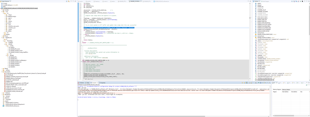

I am trying to get FreeRTOS and SEGGER SystemView (3.1) to run on an STM32F103RCTx. I used the appropriate manual from SEGGER to include all the necessary folders in my project. Although I have included all the new folders in the Include Paths I get the following error when compyling:
When searching for help with google, I often read that I have to update the Linker to see this new folder as a library. When I do so in the C/C++ settings I get the following error:
does anybody know what I am doing wrong and how I can fix this problem?

Hello Benjamin,
I have the same problem! But if you have a look well in file "SEGGER_SYSVIEW_Conf.h", no one preprocessor macros are defined probably. So, in my case there aren't any __ARM_ARCH_'V'__ defined. (I'm working with a STM32F302CB with STM32CubeIDE)
I hope some ST Member can help us to solve the problem.
