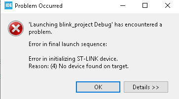

Discovery board STM32f407vg try to program stm32f405rg MCU by SWD and No device found on target error appears.

Hi, thanks for your fats reply.
Yes i've verified electrical continuity from each pin of the SWD to every MCU pin directly, the multimeter buzzes in eachone of the measures.

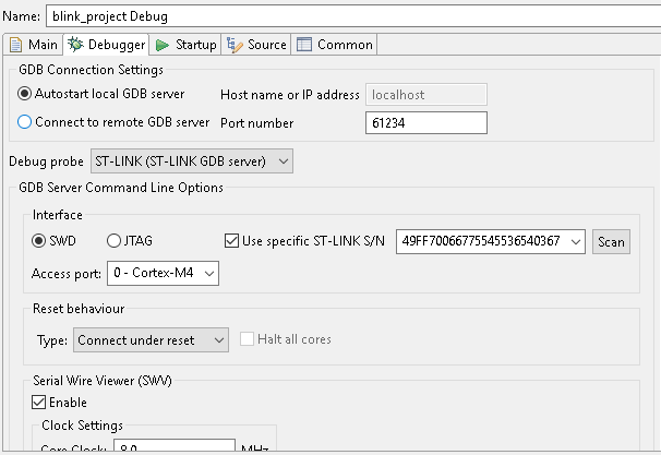

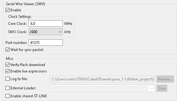

I'm using STM32CubeIDE and Keil uVision5 but i dont know how to select the system boot mode
this is how i'm configurating the debug settings.
And this is the error that appears.
