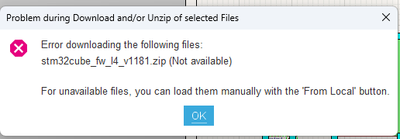

i just installed CubeIDE / MX on a brand new Computer. I am running Windows 11.
Both IDE and MX have a problem with downloading "software packages" The are extremly slow and after an hour i get an error message. I am not able to work with that behaviour.

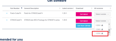

I think the cube package F4 V1.18.1 is no more available for download from ST website.
The oldest version available is at this date is V1.23.0.
So either you configure your project to point to the latest version of the HAL or open an ols ticket to get F4 V1.18.1.
