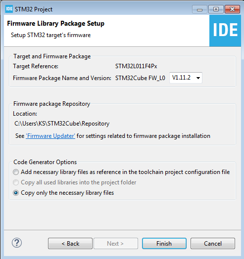

I have a trouble because I am trying to run simple code with blinking LED (with Cube IDE and ST Link v.2 mini). It is STM32L011F4P6 - without devboard - just simple mC with some resistors and capacitors, and without external oscillator.
Here's how I do it so far:

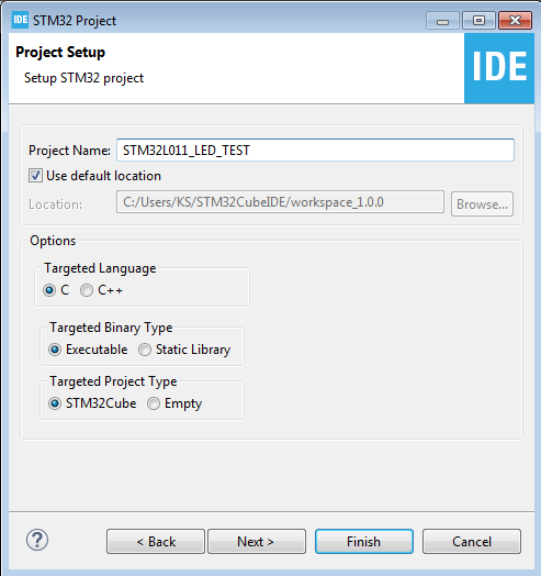

  • Opening Cube IDE, New -> STM32 project
  • Selecting STM32L011F4PX and clicking NEXT
  • Name of project and settings
Next step:
...and "Finish.

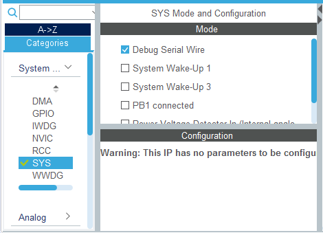

  • Now, the hardest thing (and I think this is the area where my faults can be visible:

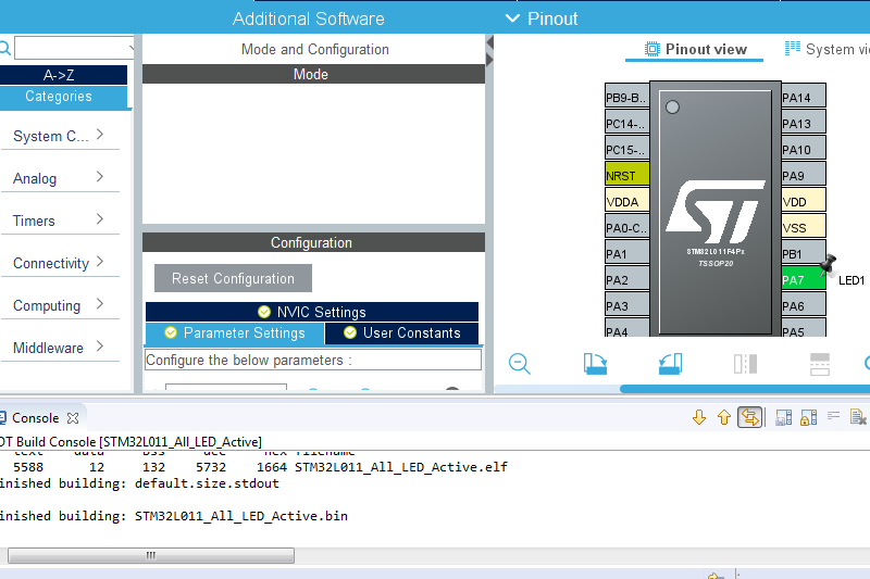

a) Set PA7 as a GPIO output and rename to "LED1" (PA7 has been connected to the anode of LED and cathode of LED to the ground.
b) Debug serial wire - selected as below:
And no other options selected in that window (maybe that's the problem?)
c) ALT+K (generate code)
  1. Now opening main.c. Code generated automatically.
  2. I added only two lines:
  3. HAL_GPIO_TogglePin(LED1_GPIO_Port, LED1_Pin);
  4. HAL_Delay(1000);

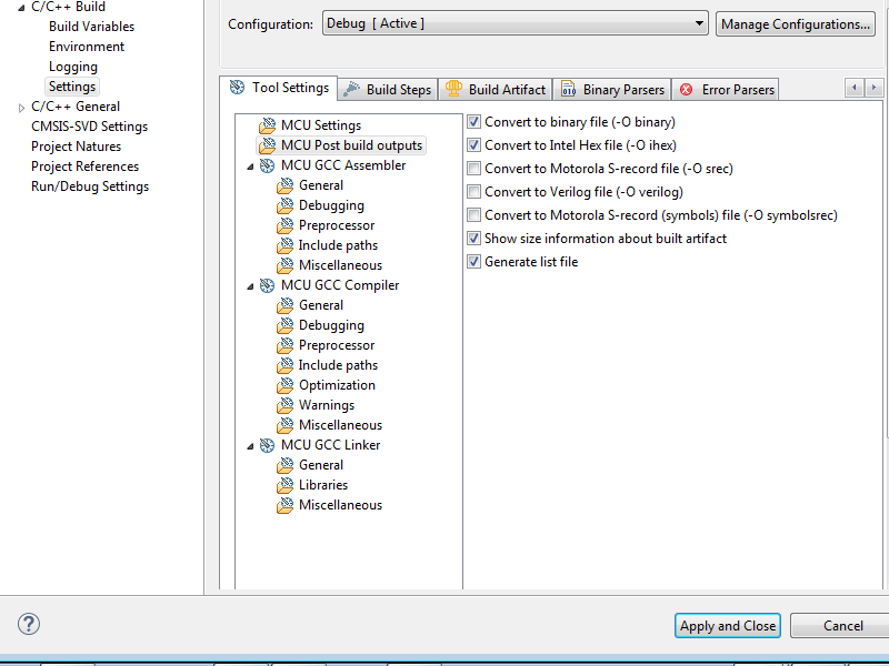

Just two lines in "while (1) {}". Now I have to set bin and hex options:
And that's all.
  1. Now build all and I have my bin which is ready to upload. I use "ST-Link Utility.
  2. ST-Link Utility: Target->Program.
  3. What I see? I see that PA7 LED is switched on... But not blinking:C Why?:c

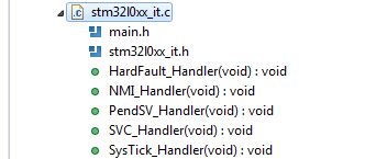

UPDATE: I noticed that only main.h from stm32l0xx_it.c was included in code. Maybe here is the problem? (picture below)
2 replies

Where are all the USER CODE BEGIN and USER CODE END tags? Doesn't look like code generated by CubeMX.
In any case, it seems you're not initializing the LED1 pin anywhere. This would usually be done in MX_GPIO_Init().
