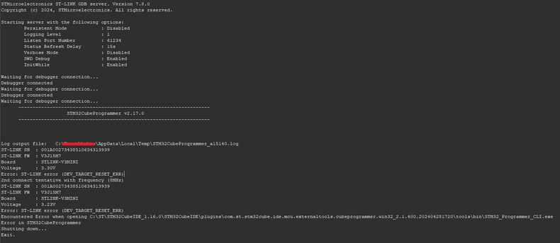

This sort of thing is a way of life with these ST tools (been using Cube IDE for 6 years on this project) but this one I am unable to fix. Is there some special setting needed under Debug (under project/properties)?
STMicroelectronics ST-LINK GDB server. Version 7.8.0
Copyright (c) 2024, STMicroelectronics. All rights reserved.
Starting server with the following options:
Persistent Mode : Disabled
Logging Level : 1
Listen Port Number : 61234
Status Refresh Delay : 15s
Verbose Mode : Disabled
SWD Debug : Enabled
ST-LINK device status: UNKNOWN
Waiting for debugger connection...
Debugger connected
Debugger connected
Encountered Error when opening C:\ST\STM32CubeIDE_1.16.0\STM32CubeIDE\plugins\com.st.stm32cube.ide.mcu.externaltools.cubeprogrammer.win32_2.1.400.202404281720\tools\bin\STM32_Programmer_CLI.exe
Error in STM32CubeProgrammer
Shutting down...
Exit.
I've tried 2 x STLINK ISOL V3 and a STLINK ISOL v2. No success.

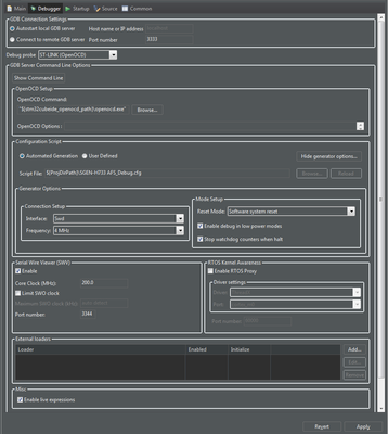

    AScha.3
    Aug 1, 2024 7:59 AM UTC
    zero + 1 . :)
    So you had it working for years...what you changed, to stop it ?
    see my setting :
    Try...(software reset  ! )

    AScha.3
    Aug 1, 2024 8:25 AM UTC
    Here i am on IDE V 1.14.1 .  (working fine - so why i should risk any "update" to unknown state ?? :) )
    + blocking all online/update search etc. -> offline mode seems helping a to keep stable workset .
    (If v 16... dont work, just use older Version and see next update for V16.. , maybe then ok again)
    ST-links i use : V3-miniE , V3-mods , V2  (the "clones" , but all with STM chips..) ;
    and also GDB and OCD ...sometimes one not working, so i choose the other. ...and back.

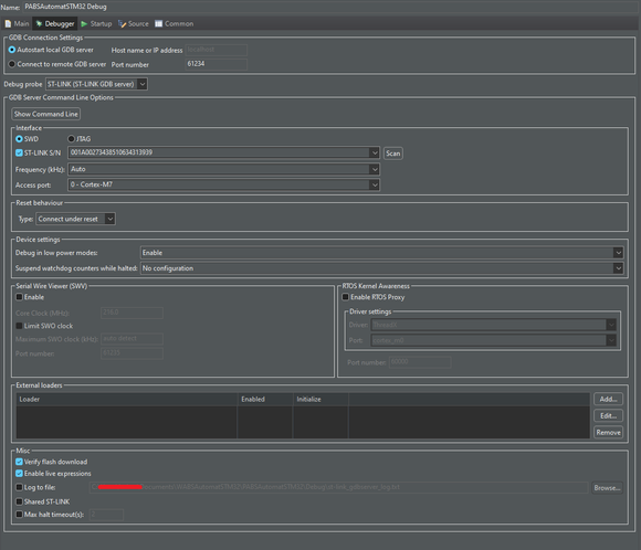

    Hi @AScha.3 , thank you for your reply.
    I'm not sure I understand your question.
    My hardware connection mode is configured like this:
    Then I use a basic USB cable.
    This setup has always worked correctly.
    The BOOT0 pin is connected to GND.
    My DEBUG configuration is done like this:
    I also updated the STLINK-V3MINI and did a ‘clean’ of the project.
    I also want to say that I managed to flash the MCU the very first time with my programme, but then it wasn't possible any more.

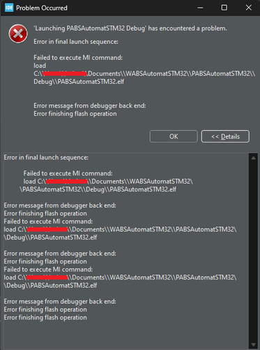

    Aug 26, 2024 8:53 AM UTC
    My hardware consists of several PCBs linked via connectors. On 2 of them there is a button that allows the uP to be reset. The aim is for the reset to be as accessible on the PCB containing the uP as it is on the one for the HMI.
    In the end, the uP reset is connected as follows:
    When I press S5, the 0 ohm resistor R50 causes a short circuit on NRST.
    According to the ST documentation, the pull-up resistor (Rpu, framed in red) for the NRST input is internal and fixed, so there is no need to add one.
    I didn't understand why it didn't work because when I used STMCubeProgrammer I could load the program without any problem.
    My intuition is that when using STMCubeIDE, at the time of debugging, the uP activates one of these outputs (framed in red) and pulls the transistor to ground. This causes the internal reset but it also causes the short-circuit due to my 0 ohm resistor R50. Conversely, when loading the program with STMCubeProgrammer, the uP does not activate the outputs because it uses the NJRST and this does not cause a short-circuit.
    I simply removed R50 and C50 and that solved the problem.
    I hope my answer is clear enough.
