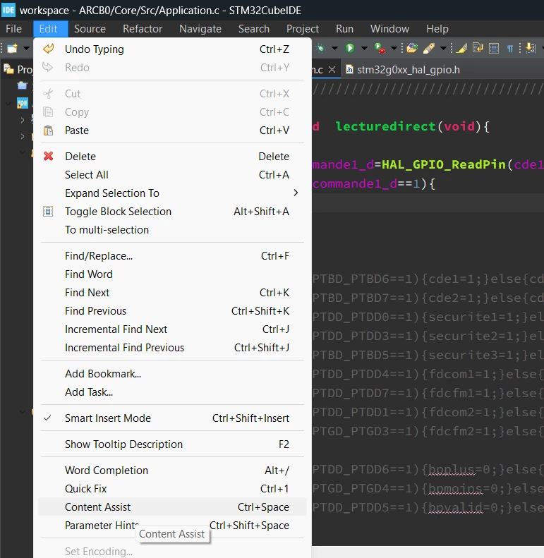

My content assist does'nt work when I press ctrl+space but it's work when go to menu edit/content assist.
Which parameter should I look ?
I tried already In Preferences -> C/C++ -> Editor -> Content Assist -> Advanced
I checked the following boxes:
  • Parsing-based Proposal
but it's does'nt work
Thanks for help

    June 22, 2023
    ok i found, I use microsoft power toys and it's use ctrl+space as shortcut too. when i inactive power toys the content assist of stm32cubeide work

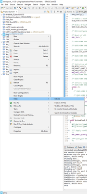

    Hello @Sebovernet
    Try to rebuild the indexer which responsible for the content assist feature.
    To do that right click on any project, go to indexer and click on rebuild as the screenshot shows.
    KR,
    Semer.
