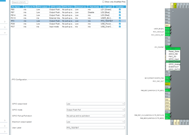

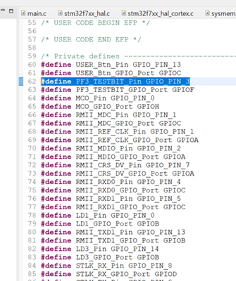

Second related to your IO control:
To control an output using HAL_GPIO_WritePin(GPIOF, GPIO_PIN_3,GPIO_PIN_SET); can be done by opening the .IOC file in STM32CUBEIDE (assuming you use this IDE). After right clicking on the IO you can used the dialog to give it a name (user label).
You select PF3, click right and then select GPIO-OUTPUT. When you save and compile you will find the defines generated in main.h.
By including main.h in your main.c, you will have access  to these defines.
HAL_GPIO_WritePin(PF3_TESTBIT_GPIO_Port, PF3_TESTBIT_Pin,GPIO_PIN_SET);
