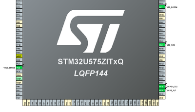

I now implementing i2c with 1 master (U575ZI-Q) and 3 slave (LK432KC).
I confirmed my code. It worked well.
but after changed title of the project and deleted some project, it made me confued,,
so I made every(1master 3slave) project new.
Here is the problem.
I think I forgot some MX configuration...
When I debug master, slave didn't receive data.
1. I use 4.7kohm external pull up resistor, so I set GPIO pullup/pulldown mode as no pull up and no pull down both master and slaves.
2. of course I changed NVIC I2C event interrupt enabled both master and slaves.
3. pinout view is like this
well.. I think master configuration could be the problem... but I'm not sure
I'll attach my master and slave main.c file
Thank you :)

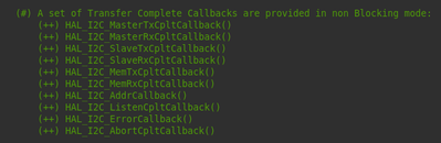

Just question : why you use INT call - if you anyway wait , until finished ?
HAL_I2C_Master_Transmit_IT()
 why not blocking then:
HAL_I2C_Master_Transmit(..)
Would be better...it waits "auto" until finished. (Same for receive.)

Well I consider both interrupt and pooling mode, and if the system have complex parallel functions (maybe inthe future...) I think interrupt is nessaray.
because external resistance is much smaller than internal one??
Right.
Maybe...but useless, if you wait for finished. (And : sure its finished, if tx empty ? It might still shift out last bits from shifter, but you do not wait for this. Did you proof , that all transfer finished and I2C stop done ? )
If using INT function, you have to use the INT , that tells you : finished now.
And "if the system have complex parallel functions" its the right way - but only if you not wait for finished, but do many other things in the time of transfer;
But if anyway need waiting, because communication is this way, use blocking function. Not more slow, same speed.
