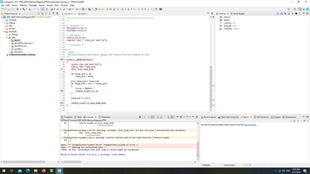

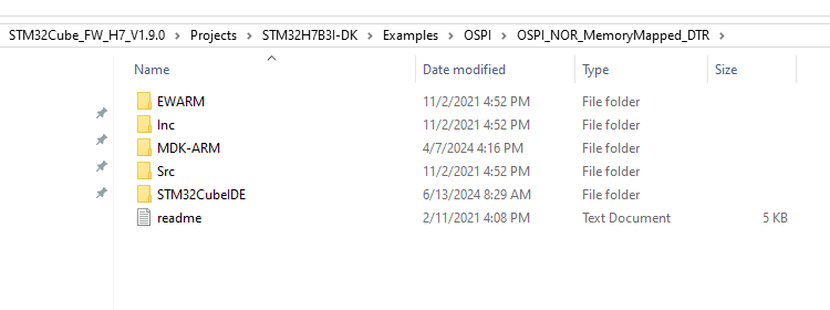

Every project in this folder for OSPI in H7 chips using CubeIDE compiles with error, Keil complies without errors
