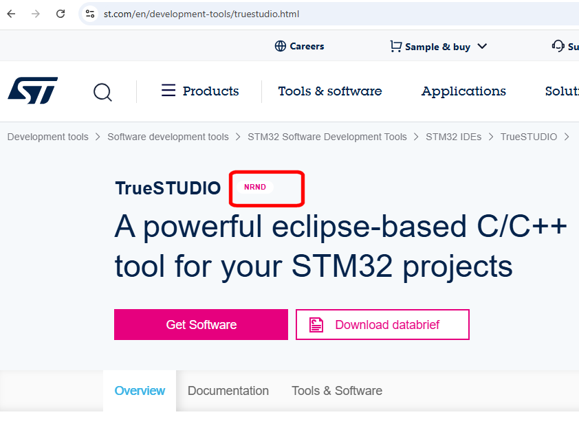

1 year later the True Studio is still not recommended for the new projects?
If it was already  not recommended a year ago, it's not going to be recommended now!
As shown on the Product Page:
PS:
In fact now the future is moving away from Eclipse (CubeIDE) towards VSCode ...
