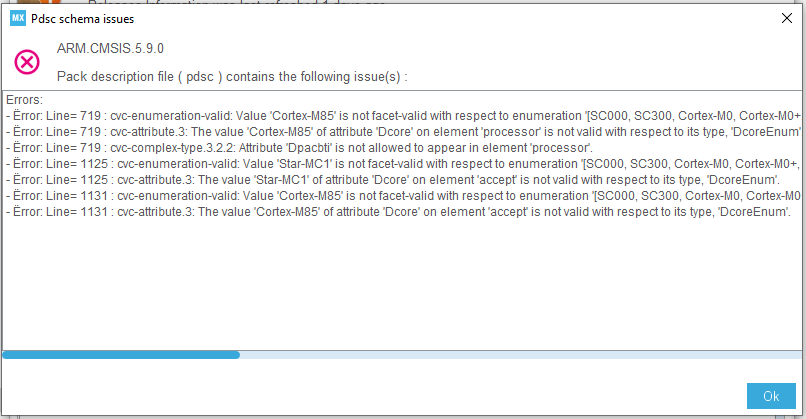

Hello Community,
I just wanted to install CMSIS Pack 5.9 in my CubeIDE (1.12.1), but the installation is canceled due to errors in the "pack" file:
ATM I am using CMSIS 5.7 Pack (Library) but for some reason the >>arm_atan2_f32<< function is missing. So the idea was to update to 5.9 (Source) and hope the function would be availiable then.
Has anyone an idea how to solve this issue?
Thanks and have a nice day!

    I have the same issue...5.9.0 will not install on CubeIDE 1.13.1
    Explorer
    August 24, 2023
    5.8.0 will install no issues...but I cannot install 5.9.0, I get the same errors as above.

    Hello @CBerg @CMMPro
    The issue of CMSIS 5.9 Pack is solved in STM32CubeMx 6.10.0.
    I suggest that you download the software from this Link.
    Thanks.
    Mahmoud.
    CBerg
    CBergAuthor
    Senior II
    November 25, 2023
    thanks for the info @Mahmoud Ben Romdhane
    I don't use CubeMX as standalone application, but as plugin for CubeIDE. I hope that fix will be availiable in CubeIDE soon, too.
