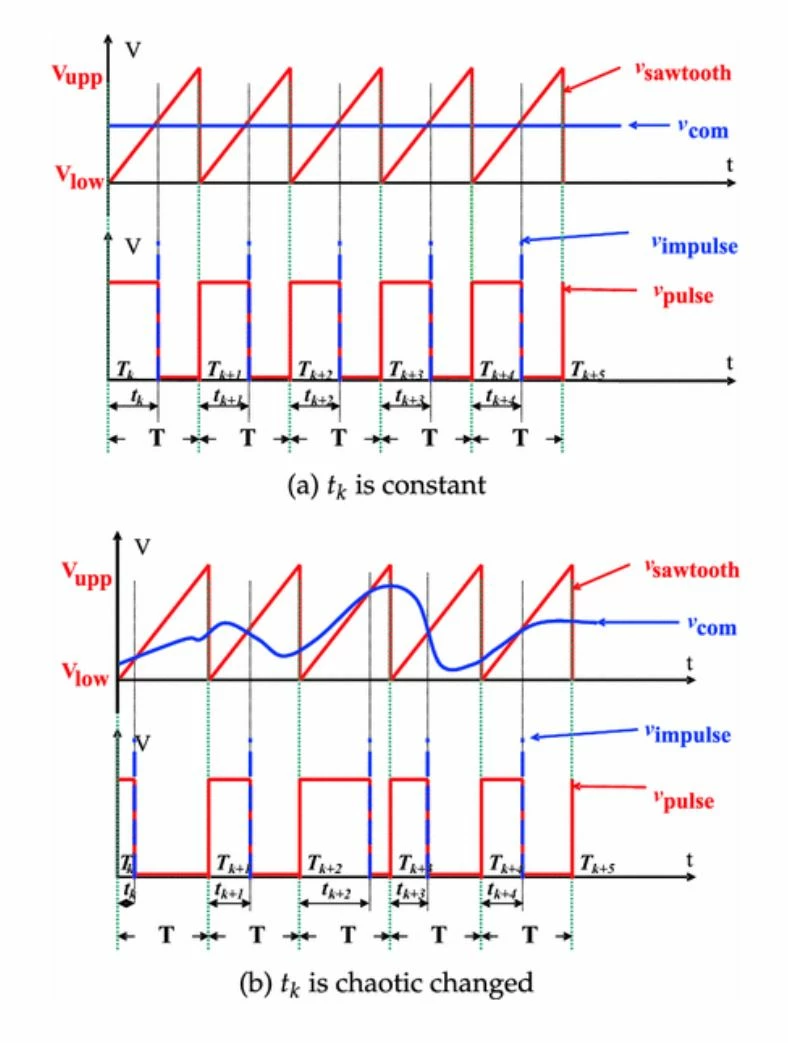

Hello!
I have never before worked with a microcontroller so all of this is very new to me. I am using the MC-kit IHM07M1 with the NUCLEO-F302R8 as a control board. I am trying to implement chaotic PWM in the microcontroller like in the figure attached. The sawtooth pulse is, as seen in the figure, an upcounting timer.
The ARR needs to be constant and the CCRx values of each channel are going to vary chaoticly. My problem is that no matter what I do I simply can't implement this in my code. I am starting with a project in MotorControl Workbench (just a default Bull-Running-Program), and from there I generete my code. This is how I set up the workflow for my code:
  1. Timer 1 and all the PWM-channels are already initiated in the Bull Running Program. The only thing I change here is the initial ARR and CRRx.
  2. Interrupt Handler Function calculates the new CCRx value and assign it to channel 1-3.

There's more code, but these are the only functions I have made changes in. The problem is that when debugging the IRQ-Handler is never entered and therefore the CRRx's is never assigned their new values.
When I run the code simply nothing happens, all the channels in Timer 1 is constantly on low (I have a LA to check this) and the motor won't run (of course) because of that.
I have been stuck for days, I hope someone can help me!

Found the problem. For some reason one element in
//Logistic map
 x[i] = mu*x[i-1]*(1-x[i-1]);
becomes negative and after that hell breaks loose and it start wandering off to infinity making
//Timer frequency
 f[i] = fc + (2*x[i] - 1)*Delta_f;
also infinite. Therefore
//Calculate the needed number to fulfill the next switching cycle period and duty cycle:
	 UpdateCycle = (F_CLK/f[i])*D/(100-1);
approaches zero. Which explaines why the PWM pulses disappears after a few seconds.
