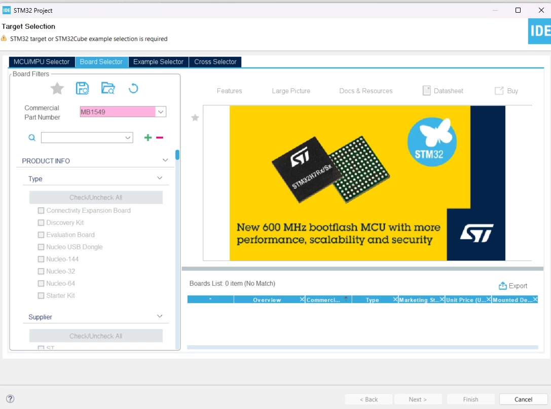

I'm used to using the stm32cube-ide. I found a Nucleo-MB1549 in my attic and wanted to play around with it but i can't seem to find it in the board selector section.
Any ideas what i should do next? This is a genuine nucleo board and i am able to find my other nucelo board using the application

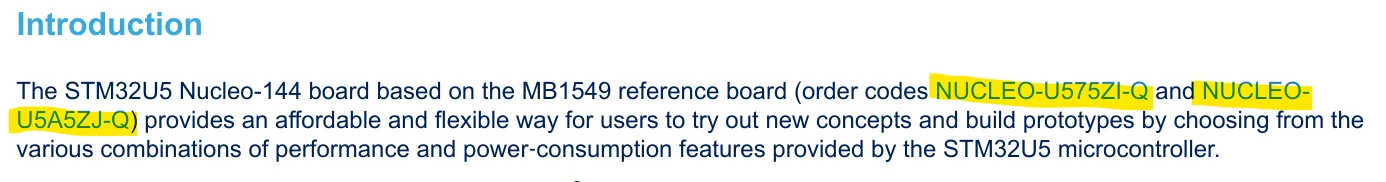

    MB1549 is the board name, but the part number is either NUCLEO-U575ZI-Q or NUCLEO-U5A5ZJ-Q. Use the one that you have.
    Should be a label on the board showing which one it is.
    July 24, 2024
    Thank you @TDK for your answer. I just got a bit confused because on the last STM32 project it said Nucelo on it and i was able to find the board quite easily
