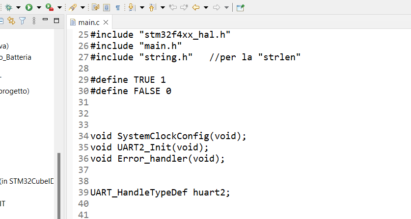

After the 1.11 update, text is no longer coloured
  • December 8, 2022
  • 4 replies
  • 1639 views
I've just updated STM32CubeIDE to version 1.11 and the labels are no longer coloured (green comments, purple "void" etc.) and I can't even find the hammer-shaped "build" button at the top to check if the code is working.
By the way, during installation of the update (performed by clicking 'help'-'about stm32' - 'installation details' - 'update') a pop-up appeared warning me that some installation files had an unknown source and asking me whether to proceed or not
Furthermore, I can no longer even create a project as I have always done with previous versions 'file'-'new'-'project' creates a simple empty folder without even allowing me to select the MCU etc.

I have the same problem. I just updated with 1.11. Not only are color configurations gone, but so is everything that has to do with building. A project that was happy before the update (and has been fine for many, many months) now is no longer.
Preferences->Builders has nothing but a request to configure the builders:
Missing builder (org.eclipse.cdt.managedbuilder.core.genmakebuilder)
Missing builder (org.eclipse.cdt.managedbuilder.core.ScannerConfigBuilder)
Furthermore, project natures are gone, run/debug settings and gone.
Since "reverting" to 1.10 didn't work. I reinstalled from scratch (rather than simply updating) 1.11. Same unusable state.
I don't have any real clue how to fix this.
