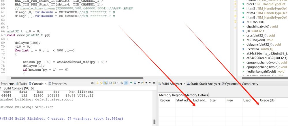

I remember that after the program was compiled, the ROM and RAM ratios were displayed in the lower right corner, but now it is gone and I don’t know how to reset it. I need help

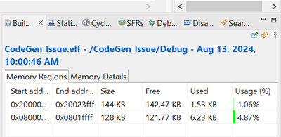

I suggest that you click on " Refresh Build Analyzer"

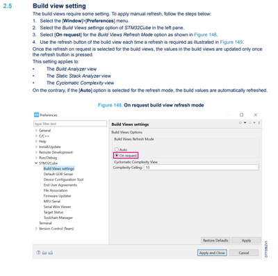

I suggest also that you refer to UM2609, section 2.5 where this new button is explained and how you can change the behavior.

Thanks.It can already be displayed
