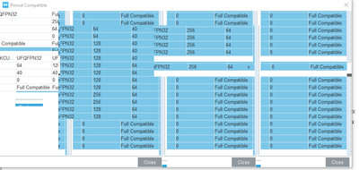

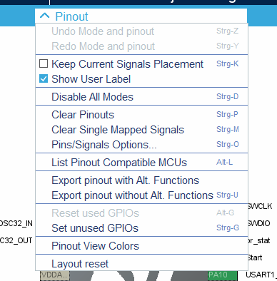

if i select in MX "List Pinout Compatible MCUs"
i get this:
Sometimes STM32CubeIDE closes without warning.
i reintalled the ide, i delete the workspace, i restart the pc, nothing helps! i change in the properties from external bowser (chrome) to internal, nothing.
Any suggestions?

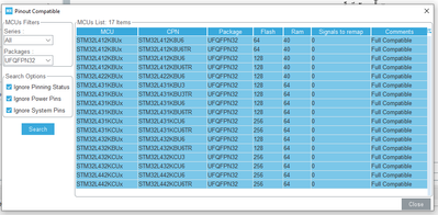

If i do the same in 1.12.1 i get  this
And this seems ok.
So i think it is one more issue in 1.13.2 :(

I don't think so. Doing this operation with the version 1.13.2 I got this:
Can you check your internal parameters?
Best regards.

Thanks Bob for the hint
with Cube Mx standalone 6.8.1 it is ok.
with Cube MX standalone 6.10 it is ok,
with the version 6.9.2 integrated in the STM IDE v 1.13.2 -> d'oh
edit:
with the brand new 1.14.0 it is ok (MX 6.10)
