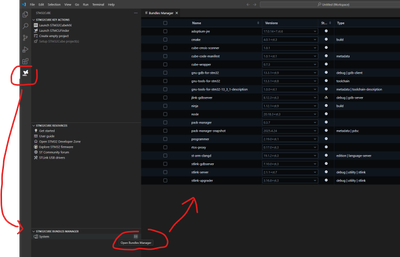

Are you able to get bundles manager populated ?

dvescoviAuthor
June 12, 2025
No. Pretty much get that error and "Bad CMake executable: "cube-cmake". Check to make sure it is installed or the value of the "cmake.cmakePath" setting contains the correct path"
Errors all the time while the extension is loading.
After everything loads ... for the most part it works fine.

?? May you have quarantine issue Thanks some antivirus scan or ? Sounds like you are kind of facing issue with some executable.
What "or the most part it works fine" means ? Are you able to build / debug ?
On my side cube-cmake is here:
Are you getting this executable right ?
