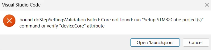

I migrated my V2 extension to V3 (3.6.4) on Dec 11 2025 (just before the v3.7.0 release), updated my debug workflow / launch.json etc, my STM32H745I discovery board was running my TouchGFX application (basically stock TouchGFX Designer generated app w/ CMake) fine with Dual Core debugging (new shared debugger / simplified Launch/Tasks.json is a massive improvement on my old/convoluted tasks/launcher workflow, my sincere thanks).
Just tried to re-run the same code stack with my code with the new 3.7.0 extensions, hit a launch error relating to my launch.json:
Extension seems to have lost context of my ide.store.json files in the project subfolders:
 // 'CM4/.settings/ide.store.json' - This line not in actual file
 "device": "STM32H745XIH3",
 "core": "Cortex-M4",
 "order": 0,
 "toolchain": "GCC"
(Similar for the CM7 version targeting the M7 core)
Re-running the STM32Cube Project setup configuration didn't seem to fix it, so I just added 'deviceName' and 'deviceCore' manually to my launch file CM4/CM7 configurations, but would ideally like that bug fixed for dual core projects)
Now running my "DualCore_Debug" compound config throws a gdb server startup issue on the CM4 half of the attach:
With an underlying warning on the CM4_Debug log:
'From Debug Session: step debug conf validation: No image file loaded, see imagesAndSymbols attribute in the debug configuration.'
And the CM7 debugger runs as normal / stops at main, but messes with the dual core startup ASM file timing (stock CM4 domain stop and wait for CM7 configure / continue) so that my application won't initialise correctly, the build is fine, as my app will run in flash / non-debug mode.

Can you please recommend any launch.json changes required to match the patches in 3.7.0?
Or otherwise let me know if it's an issue with the version update, it seems that Ln50 of the launch.json is the source of the issue, gdb no longer being okay with just a symbol file load.

Same as you with the H7, but I just need to add the deviceCore attribute.
Be careful with the compound debug configuration because the launches are done simultaneously, not sequentially.
This can cause race conditions between the CM7 flashing the CM4 and the CM4 itself loading the symbols.
I saw on stackoverflow that some use a preLaunchTask on the second debug configuration to add a timer, but I’m not a fan of this solution.

Removing the specific access point in the CM4 seems to fix the debugger stall issue for CM4 (i.e. comment out serverAPID) and allow dual core debugging. The CM4 debug log warning about no images being loaded seems to be a red herring, please advise if there is a way to suppress this (as it will always flag for H7 dual cores). The extension seems to crash on loading ELF images during the CM7 CubeProg run about 20% of the time but I can live with that.
