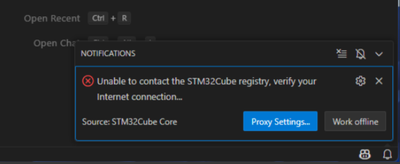

The latest version of STM32CubeIDE for VSCode can have its performance affected by network conditions when working online. If the network is disconnected, the entire set of plugins may become unresponsive for a long time (ten or so minutes) before switching to offline mode. The whole plugin suite should be designed to primarily work offline, performing occasional network tasks in the background intermittently.
最新版的stm32cubeide for vscode ,在联网工作的时候,性能会被网络状态影响。如果发生了断网,则整个插件组会假死很久(十几分钟),才能切换到离线工作状态。整个插件组应该设计成离线工作为主,在背景状态、间歇性进行一些联网工作。

Thank you for sharing your feedback.
I completely agree; a 10-minute delay is obviously far too long.
I must confess that we have not yet invested much in the specific usage scenario you mentioned, so it’s understandable that your experience is suboptimal.
The 10-minute delay is definitely excessive. Have you had a chance to manage this notification during VS Code startup? I suspect this might be the cause of your delay. However, I want to be honest: even after addressing this, the experience won’t be perfect—only a partial improvement can be expected.
I appreciate your comments and are actively working to improve the overall experience. For now, please consider that this solution requires an active internet connection.
We also can acknowledge that the VS Code ecosystem promotes a connected environment (marketplace, continuous updates, Copilot assistance, etc.), but your valid use case cannot be ignored.
I will keep you updated on future progress. While we aim for an ultimate solution, we expect to deliver quick improvements over time.
