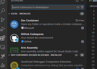

  • When installing an extension and creating a DevContainer the extension is not automatically installed /imported to the DevContainer
    To add the needed extensions, you need to click on the cloud icon and select the extensions to be added to the DevContainer.
  • Second issue after clicking on this icon, the install process on the DevContainer is not stable, sometimes you may need to relaunch the process twice or three times to have all your extensions installed.
  • Third issue after adding all the needed extensions to the DevContainer, you may not be able to use them as VSCode is prioritizing the local installed one, so you must disable the local extension to be able to use the instance in DevContainer.
  • Same issue and fix if you are using different dev profiles
Workaround
To resolve this with the workaround, please follow these steps:
  1. Open your user settings .json file.
  2. Add the following code:
json
"remote.extensionKind": {
 "stmicroelectronics.stm32-vscode-extension": [
 "workspace"
Note: This is a workaround, and we are actively discussing with Microsoft to fix the issue.
