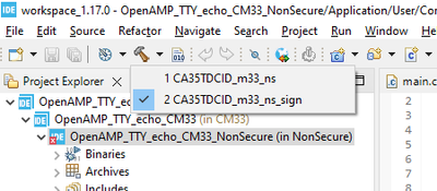

Basically I wanted to start with an example on the M33, and started with the following link: Modify, rebuild and reload the firmware - stm32mpu
the project : OpenAMP_TTY_echo is loaded correctly, and the build of _ns is completed OK
When I choose (with the hammer) the _ns_sign

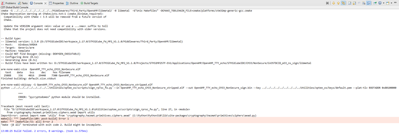

I get this error :
Th trackback shows: ImportError: cannot import name 'utils' from 'cryptography.hazmat.primitives.ciphers.aead' (C:\Python\Python310\lib\site-packages\cryptography\hazmat\primitives\ciphers\aead.py)
It looks like a python path issues of the STM32CubeIDE,
How should I sol

‎2024-12-31 4:23 AM
Hi
Updating that the issue was solved by
uninstalling Cryptography => pip uninstall Cryptography
re installing Cryptography version 3.1.1 => pip install Cryptography==3.1.1
checked this externally in command prompt running: python sign_rproc_fw.py from the directory of installation (
