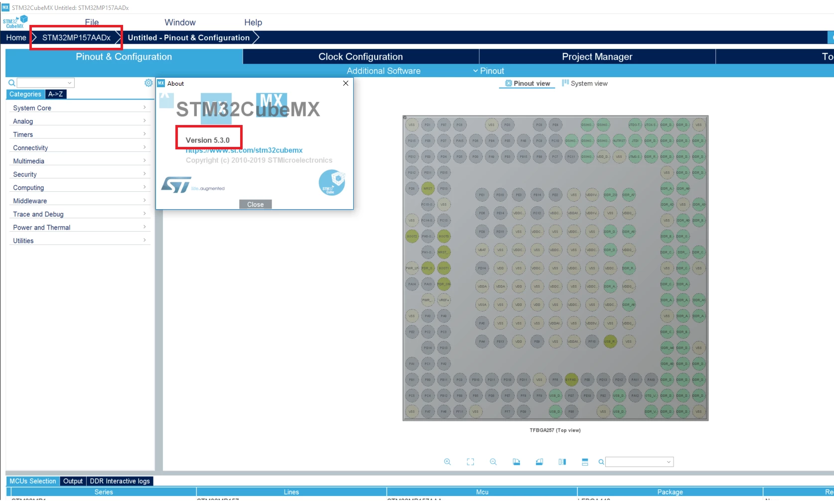

Khouloud ZEMMELI
August 29, 2019
@Predd.11​ ​, Please try with the latest version of CubeMX  -5.3.0- .
Best Regards,
Khouloud.

Khouloud ZEMMELI
August 30, 2019
​You're welcome,  the SW4STM32 is available so you can use it. (and not only by using linux)
