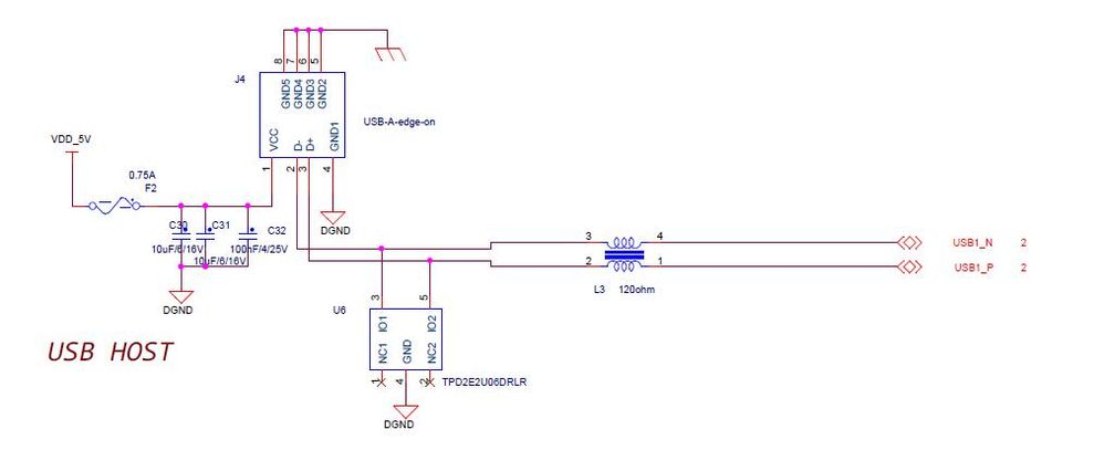

Why does the USB mouse not work on STM32MP157 USB1?
  • September 11, 2019
  • 4 replies
  • 2374 views
We have a design with a USB HOST, the schematic is shown below, And the system is Linux 4.19. We have add some configuration about USB HID as below:

If we connect the USB Mouse directly to J4, it does not work(The LED on the USB mouse is on), but the USB Stick works;

If we connect a USB Hub to J4, and connect the USB Mouse to the USB hub, it works.
Best answer by AntonioST
I suspect the OHCI is not enabled, but "dmesg | grep usb" does not show it. You should try "dmesg | grep -i ohci"
The wiki page
https://wiki.st.com/stm32mpu/wiki/USBH_device_tree_configuration
reports the settings for enabling ohci.
Please note that ohci is not enabled on the ST boards because both include on-board a USB hub.
4 replies
AntonioST
AntonioSTBest answer
September 11, 2019
The wiki page
SunnyGeGe
SunnyGeGeAuthor
September 11, 2019
Thank you for your reply, AntonioST!
After enabling ohci, the USB mouse works.
