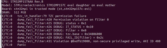

Custom STM32MP157AAA3 board,  512MB. TF-A OP-TEE in SYSRAM
Two outcomes.
[a] building u-boot with stm32mp1_trusted_defconfig : boot loops around (restart), does not even reach u-boot
[b] building u-boot with stm32mp1_defconfig: dump_fail_filter:425 Violation @0xdfb19000, non-secure privileged write, AXI ID 480
This area  was firewalled in fw-config.dts based on the Wiki how to configure FW-CONF and also added as a reserved area in TF-A, OPTEE and u-boot DT,  Though u-boot (or something else for that matter) tries to access this area ?

Even there is a u-boot sign on, the actual error occurs in tzc400.c in the OP-TEE code tree in the dump_fail_filter function . That was a bit misleading, I was assuming u-boot is running, and perhaps it is, but the memory access could be checked by OP-TEE code. not sure how this works but guess  OPTEE is a "service" to u-boot
it is a PRIVILEGED write but a non-secure access. I interpreted that as that caller has right to access the memory area but not for write access. Perhaps that is a wrong conclusion.
it reports filter "0" , where can this filter be found ? what is AXI ID 480 ?
io_read32(tzc.base + FAIL_ID(filter))) = 480
EMSG("Violation @0x%"PRIx64", %ssecure %sprivileged %s, AXI ID %"PRIx32,
addr,
nonsecure_not_secure(filter) ? "non-" : "",
priv_not_unpriv(filter) ? "" : "un",
write_not_read(filter) ? "write" : "read",
io_read32(tzc.base + FAIL_ID(filter)));

E/TC:0 tzc_it_handler:79 TZC permission failure
E/TC:0 dump_fail_filter:420 Permission violation on filter 0
E/TC:0 dump_fail_filter:425 Violation @0xdfb19000, non-secure privileged write, AXI ID 480

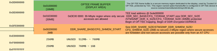

Did a complete exercise to compare the WIKI (ref "256/512MB WIKI") to the actual ECO 5.0 source code:
Ref: https://wiki.st.com/stm32mpu/wiki/How_to_configure_a_256MB_DDR_mapping_from_STM32_MPU_Distribution_Package
In make build command AARCH32_SP_OPTEE=1 and STM32MP1_OPTEE_IN_SYSRAM=1 were applied
From stm32mp15-fw-config.dtsi:
#define DDR_NS_BASE STM32MP_DDR_BASE
#ifdef AARCH32_SP_OPTEE
#define DDR_SEC_SIZE STM32MP_DDR_S_SIZE
#define DDR_SEC_BASE (STM32MP_DDR_BASE + (DDR_SIZE - DDR_SEC_SIZE))
#define DDR_NS_SIZE (DDR_SEC_BASE - DDR_NS_BASE)
#else /* !AARCH32_SP_OPTEE */
#define DDR_NS_SIZE DDR_SIZE
#endif /* AARCH32_SP_OPTEE */
From /plat/st/stm32mp1/stm32mp1_def.h"
STM32MP_DDR_BASE U(0xC0000000)
from /plat/st/stm32mp1/stm32mp1_fip_def.h:
STM32MP_DDR_S_SIZE U(0x02000000) /* 32 MB */
from the dtsi generated by CubeMX /fdts/<board>-mx-fw-config.dts:
DDR_SIZE 0x20000000 /* 512MB */
Thus:
DDR_SEC_SIZE = 0x02000000
DDR_SEC_BASE = 0xC0000000 + (0x20000000 - 0x02000000) = 0xDE000000
DDR_NS_SIZE = 0xDE000000 - 0xC0000000 = 0x1E000000
firewall: From: https://wiki.st.com/stm32mpu/wiki/How_to_configure_TF-A_FW_CONFIG:
memory-ranges = <
DDR_NS_BASE DDR_NS_SIZE TZC_REGION_S_NONE TZC_REGION_NSEC_ALL_ACCESS_RDWR
30MB_SECURE_REGION 30MB_SECURE_SIZE DDR_SEC_SIZE TZC_REGION_S_RDWR 0
2MB_NON_SECURE_REGION 2MB_NON_SECUE_SIZE TZC_REGION_S_NONE TZC_REGION_ACCESS_RDWR(STM32MP1_TZC_A7_ID)
Issues:
[1] For 512 MB, The "256/512MB" WIKI lists for the  512MB configuration  DDR_SEC_BASE = 0xDE200000 while after the source code compilation DDR_SEC_BASE results in 0xDE0000000 (de-compling fw.config.dtb also hows this value for DDR_SEC_BASE)
[2] The "256/512MB" WIKI mentions 30MB is DDR_SEC_SIZE, (0x02000000) while the actual source code this is named as DDR_NS_SIZE (non secure?) (0x01E00000)
[3] The 2MB_NON_SECURE (shared) region mentioned in the "how to configure FW_CONFIG" is missing in stm32mp15-fw-config.dtsi generated by CubeMX.
[4] DDR_SHARE_BASE is mentioned in the "256/512MB" WIKI, but not in the actual source code. It was removed from TF-A source code by a patch:
./tf-a-stm32mp-v2.8.6-stm32mp-r1-r0/0001-v2.8-stm32mp-r1.patch:8497:-#define DDR_SHARE_BASE (STM32MP_DDR_BASE + (DDR_SIZE - DDR_SHARE_SIZE))
./tf-a-stm32mp-v2.8.6-stm32mp-r1-r0/0001-v2.8-stm32mp-r1.patch:8501:-#define DDR_SEC_BASE (DDR_SHARE_BASE - DDR_SEC_SIZE)
./tf-a-stm32mp-v2.8.6-stm32mp-r1-r0/0001-v2.8-stm32mp-r1.patch:8531:- DDR_SHARE_BASE DDR_SHARE_SIZE TZC_REGION_S_NONE
[5] For OP-TEE and U-BOOT optee_framebuffer: where and how can this address be determined ? Based on the "256/512MB" WIKI this should be DDR_SHARE_BASE but based on the actual source code (see above) this is the same as DDR_SEC_BASE (0xDE000000 for 512MB), that should not be correct.
[6] in U-bOOT: in the "256/512MB" WIKI the optee region is defined as DDR_SHARE_BASE, but this is removed in the source code by the patch. How can this address and size be determined ?
I could have something wrong, but ST please take a look at these. Due to this I am not able to configure the DT's correctly. Please add a WIKI how to configure U-BOOT, FW-CONFIG and OPTEE DT for STM32MP157 with  512MB. Thank you.

The "256/512MB" WIKI states for OPTEE:
The OP-TEE memory configuration is defined in the file core/arch/arm/plat-stm32mp1/conf.mk
CFG_TZDRAM_START ?= ($(CFG_DRAM_BASE) + $(CFG_DRAM_SIZE) - $(CFG_TZDRAM_SIZE))
= 0xc0000000 + 0x10000000 - 0x1e00000 = 0xce200000
CFG_SHMEM_START  ?= ($(CFG_TZDRAM_START) - $(CFG_SHMEM_SIZE))
= 0xce200000 - 0x200000 = 0xce000000
These definitions are not in the conf.mk for for STM32MP15
debugging
Lead
There were issues about the location of the shared memory before:
https://github.com/OP-TEE/optee_os/issues/5275
ST TF-A v2.6 (e.g. tag v2.6-stm32mp-r1) and mainline OP-TEE don't comply on the location of the secure memory and reserved shared memory in DDR. ST TF-A v2.6-stm32mp-r1 locates the 2MB rsv shm below the 30MB secure DDR whereas mainliine OP-TEE (and mainline TF-A v2.6/v2.7) locates the rsv shm above the secure DDR area. Once consistent, boot is fine.
My best guesses are
1. That the memory map is as follows:
2. that for the DT's the following values should be used:
OPTEE_FRAMEBUFFER: = 0xDD000000 size 0x01000000 (in u-boot DT "optee-framebuffer)
DDR_SEC_BASE  / SIZE =  0xDE000000 0x02000000  (in optee and uboot DT for "optee" and fw-config.dts firewall)
DDR_SHARED_BASE / SIZE = 0xDFE00000 0x00200000 (in fw-config firewall)
3. That the regions in the firewall in (in board-fw-config.dtsi) should be defined as follows:
//#define DDR_SEC_SIZE STM32MP_DDR_S_SIZE
//#define DDR_SEC_BASE (STM32MP_DDR_BASE + (DDR_SIZE - DDR_SEC_SIZE))
#define DDR_SHARE_SIZE 0x00200000
#define DDR_SEC_SIZE (STM32MP_DDR_S_SIZE - DDR_SHARE_SIZE)
#define DDR_SEC_BASE (STM32MP_DDR_BASE + (DDR_SIZE - DDR_SEC_SIZE - DDR_SHARE_SIZE))
#define DDR_SHARE_BASE (DDR_SEC_BASE + DDR_SEC_SIZE)
That is:
DDR_NS_BASE = 0xC0000000
DDR_NS_SIZE = 0x1E000000
DDR_SEC_SIZE 0x01A00000
DDR_SEC_BASE = 0xDE000000
DDR_SHARE_BASE = 0xDFE00000
memory-ranges = <
DDR_SEC_BASE DDR_SEC_SIZE TZC_REGION_S_RDWR 0
// PATCH Added for firewall shared memory 2MB area below top of DDR
DDR_SHARE_BASE DDR_SHARE_SIZE TZC_REGION_S_NONE TZC_REGION_ACCESS_RDWR(STM32MP1_TZC_A7_ID)

Conclusion,  still the same error:
U-Boot 2022.10-stm32mp-r1 (Sep 21 2023 - 11:44:11 +0800)
CPU: STM32MP157AAA Rev.B
Model: STMicroelectronics STM32MP157C eval daughter on eval mother
Board: stm32mp1 in trusted mode (st,stm32mp157c-ev1)
DRAM: 512 MiB
E/TC:0 dump_fail_filter:425 DEBUG: status = 0x1
E/TC:0 dump_fail_filter:426 DEBUG: IT_STATUS = 0x10
E/TC:0 dump_fail_filter:427 DEBUG: filter = 0x0
E/TC:0 dump_fail_filter:428 DEBUG: tzc.base = 0x34806000
E/TC:0 dump_fail_filter:429 DEBUG: FAIL_ID(filter) = 0x2c
E/TC:0 dump_fail_filter:431 Violation @0xdfb19000, non-secure privileged write, AXI ID 480
E/TC:0 Panic

These  are settings from OP-TEE conf.mk
CFG_TZDRAM_SIZE ?= 0x02000000
CFG_DRAM_BASE ?= 0xc0000000
CFG_DRAM_SIZE ?= 0x20000000
= 0xC000000 + 0x20000000 - 0x02000000 ) = 0xDE000000   => This matches the  memory map as best guessed above and  is DIFFERENT than in the WIKI https://wiki.st.com/stm32mpu/wiki/How_to_configure_a_256MB_DDR_mapping_from_STM32_MPU_Distribution_Package
0xde200000 | DDR_SEC_BASE/CFG_TZDRAM_START
 So which one is correct. the WIKI or STMCubeMX and ST's source tree code ?
