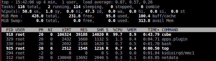

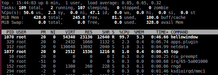

Hello Bernard, thanks for you answer.
The hellowindow application looks well, but use the 100% of cpu.
The cube application move 1 frame each 3 seconds and use 100% of CPU.
We test the GTK environment and looks like use the gpu in correct way, but Qt looks like doesn't use it.

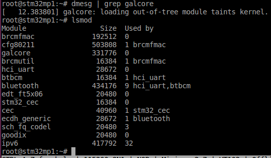

I/ Could you please check on your board:
1. GPU kernel driver is well probed:
root@stm32mp1:~# dmesg | grep galcore
[ 8.038278] galcore: loading out-of-tree module taints kernel.
root@stm32mp1:/usr/lib# lsmod | grep galcor
galcore 331776 0

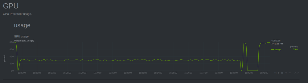

On my side I have the following results:
- hellowindow (less than 10% cpu and 30% gpu):
- cube (around 10% cpu and 80% gpu):

Hello Bernard, thaks a lot for your answer.
Answering your questions:
The module is not loaded, due that the st-example-image-qt doesn't generate the module.
The /lib in vendor folder doesn't exist.
I have make several test:
- compile again the recipe st-example-image-qt without webkit and modifying the flashlayout in order to increase the space in sdcard partition, the installation finish without problems.
- the st-example-image-qt doesn't generate the galcore.ko module, is needed add the package "gcnano-driver-stm32mp" to st-example-image-qt.bb, then the galcore module appear in dmesg (is loaded by kernel)
- The libGLES only is installed in /usr/lib/
/usr/lib/libGLESv2.so.2 -> libGLESv2.so.2.0.0
/usr/lib/libGLESv2.so.2.0.0
- In /vendor doesn't appear any lib folder

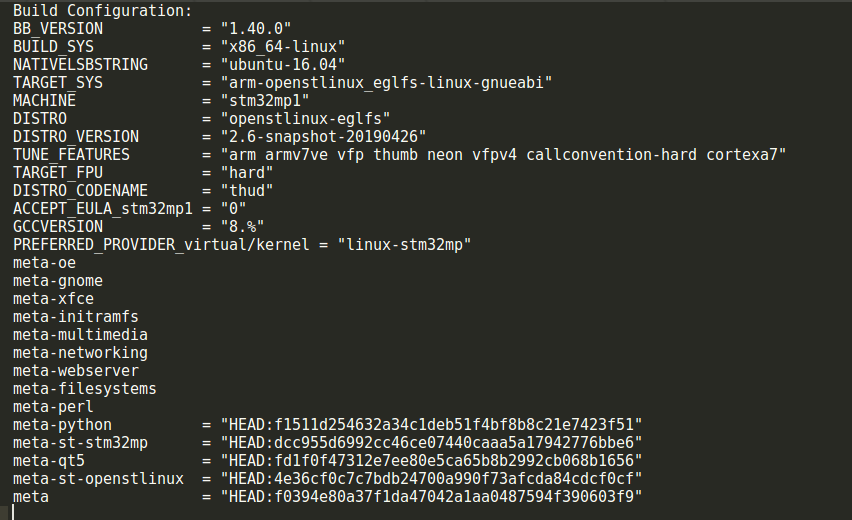

Build Configuration:
Galcore kernel module:
After these changes we have the same issue, the system doesn't use the GPU.

‎2019-04-29 6:32 AM

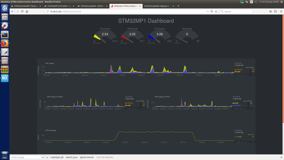

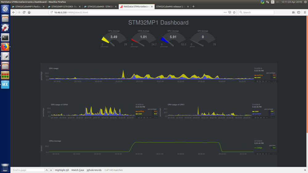

Hello Bernad, thanks a lot for your answer.
You are right, just adding the EULA agreement, the GPU works like expected. (ACCEPT_EULA_stm32mp1 = "1" at local.conf)
CPU use "cube application"
GPU use "cube application"
Thanks again for your help, we can continue testing the MPU features.
Best Regards
Eduard Gavin
